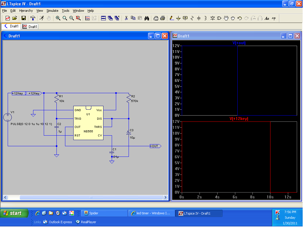

I drew up the circuit for final revision but I do have some questions, If the trigger pin is wired directly to the 0v, will the 555 timer run its cycle the moment it gets power? Also I assume that the output will be the same voltage as the VS?
Hope it's good.

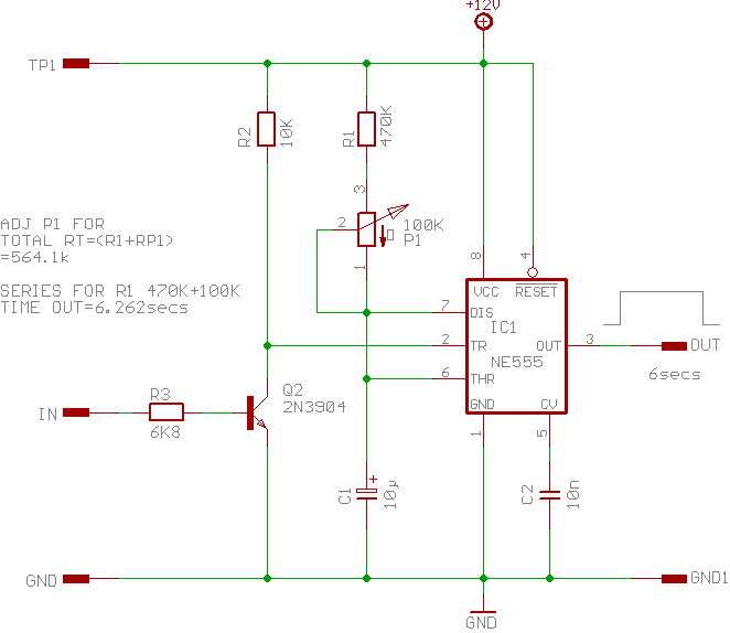

Hi salutka,
you don't need to use a big electrolytic cap for the circuit. Reduce the capacity to 10µF and use a resistor of 570KΩ instead of 12KΩ.
The exact resistance value 546.1KΩi s achieved best by using a combination of a fixed value resistor (470KΩ) and a trimmable resistor of 100KΩ.
570KΩ will result in a time out of 6.262seconds. For an electrolytic I suggest to use a tantalum type capacitor.
Don't forget to smoothen the alternator voltage. (Not included in the schematic)
Boncuk
P.S. There is a small error in the schematic. The total resistance value has to be 546.1K.

So the IN with the 6.8k resistor and the TP1 have to be connected to the 12v?
And is your mistake the leg #1 of your variable resistor?
TP1 goes to the positive battery terminal and IN goes to the key switch.

570kΩ is not a standard value, the nearest standard value to 546.1k is 549k which is a 1% tolerance resistor.
In practise, there's no point in using such a precise resistor value because the 10µF capacitor will be 10% at best so use a 560k resistor.

My statement was: 470K + 100K (not 570K as a single resistor). To compensate for capacitance deviations he should use the circuit as is - with a trimmable resistor.

I know its been a while but I'm having problems with this circuit, the major one is that when the transistor brings the trigger to 0V for more than 6 seconds the output remains high. I know the circuit works because if I send voltage to the transistor the timer outputs 11v for 6 seconds. Another problem, but not that major is the transistor is too sensitive, meaning that even if I just touch the base (2n3904) with my finger it triggers, so I think I would need a way to stabilize and filter it. One more thing I used a 6.2k instead of a 6.8k on the base, I don't think it makes that big of a deal but U never know. Thanks.
Timer
The 555 doesn't like to have the trigger input low when it times out and will re-trigger. You could fix that by AC coupling the trigger to develop a short pulse. The sensitivity is probably because the the base of the transistor is "floating" when the key is off. This could be fixed with a resistor from the base to ground - say 20K.
You might consider the circuit below. It triggers only once when the key is turned on and only draws power when the key is on.

I'm not familiar with AC coupling and the "V1" component in your design. I see you kept every thing as-is pretty much, so your design will be easy to implement. If you can send me a part number I would really appreciate it! Thanks.
V1 is just there for the simulation. Connect your key switch to that point.
