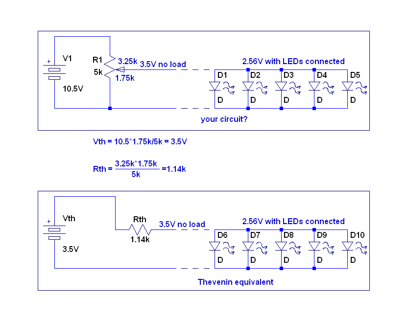

I am experimenting with multiple LEDs in a parallel circuit. I bought some 2-pack Radio Shack high brightness white leds which are rated 3.3v+ forward voltage and 25 mA current on the package. Using an on-line led parallel calculator I deterimined that 5 of these LED's in parallel should require no resistor if supply voltage is in the 3.5v ballpark. In testing, I determined that they did indeed light properly at 3.5v on up to 3.8v. I did not want to burn them out by applying higher voltage. My supply voltage came from a 10.5v (1.5 amp) power supply hooked up to a 5k ohm pot.

- No-load voltage is definitely showing 3.5v to 3.8v. But hooked up to the LED's the supply voltage reads 2.56, no matter where the supply voltage was set (3.5 to 3.8). Is there a reasonably simple explaination for where the missing 1.2 supply volts went? Should I recalculate a higher supply voltage and stick a resister in for stability?

My best guess is that you are using the circuit below. The top circuit is my guess of how you are driving the LEDs. The bottom circuit is the Thevinin equivalent of it. This would explain the discrepancy between open circuit and closed circuit voltages.
I don't understand, though, how you would get significant light from 5 LEDs that are sharing approximately 1mA.

The top circuit is exactly the way I set it up. Note that I have never left it hooked up for more that 20 seconds or so because I was worried about burning up the LEDs. Looks like that was a good precaution. I am going to Radio Shack today to buy a 500 pac of assorted 1/4W resistors. Hopefully I will get at least 5 of the same in the range required. If I find 5-47 ohm, or 60 or 70 ohm, I will run the circuit through one of the on-line calculators and adjust the supply voltage accordingly.
