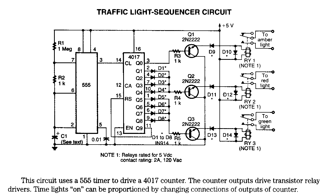

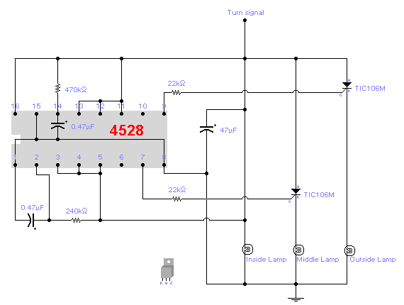

I want to be able to replace the taillighs in my car with LED's I plan on using a Multiple LED array for each taillight. Most likely 100+ per side. These will act as the taillights, brake lights, and blinkers. So here's my delima.
I need to be able to have the LED's at a lower intensity when in "Taillight" mode, and when in "brake light" mode they need to be brighter. Now the tricky part, I'd like to be able to be able to make the LED's flash in sequence in the direction i'm turning. I will have a different 12v Input for each of the 3 functions but how do I wire the LED's to multiple circuits to acheive the desired effect? I was thinking of using a decade counter for the sequence part, is there a way to tell the decade counter to illuminate all the LED's at once? if so this wouldn't be too hard. I dunno, there's many different ways to do this, do you guys have any pointers?
here's the design i was thinking of starting out with.
U2 is a 4017 Timer
U1 is 4011 NAND Gate
Tricky to incorperate with break lights and emergency flashers and parking lights.

Parking lights, brake lights, and turn signal... If I remember correctly, these are all seperate bulbs usually. You could set your LEDs for partial brightness (resistor), use the wire from the brakelight through another resistor to add enough for full brightness. Interlace the sequencial turnsignal LEDs with the the other ones. This will leave gaps in between the two, but should function.
3 bulbs into two sets of LEDS, but you will have to do it twice (right and left).
A microcontroller should have no problem reading 4 inputs, just not sure how well it can control all those LEDs... Oh, forgot about hazzard lights, when you get like a flat tire.
