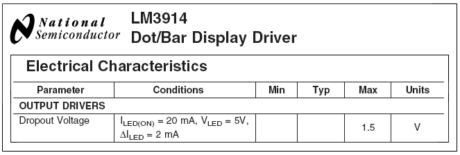

Nope. That is the supply voltage operating range for the guts of the IC, but the current-regulated outputs can have a separate supply voltage from the LEDs.
The current regulation for the LEDs works by adjusting the conductance of an output transistor to ground. The more voltage across the transistor, the hotter it gets. The transistor "drops out" of regulation when the voltage at the cathode of an LED connected to it is at most, 1.5V. At dropout, the current in the LED is reduced by 10% which you probably wouldn't notice.

So roughly 1.5V is a maximum for "dropout", and thus a minimum for keeping all LEDs properly lit?
This is all new terminology to me, and it is a bit overwhelming :shock: .
Also, the condition set above do not meet mine. Is there a way to find out (yeah, it is probably in the DS, but I don't understand most of the data) what the dropout voltage would be for roughly 10.4 mA per LED and 10.3V across the IC?
Correct, for the outputs of the LM3914, plus the voltage of the LEDs to reach the minimum supplyvoltage for the LEDs.
You don't need to know the actual dropout voltage, it is guaranteed to be less than 1.5V. You do need to know the actual operating voltage of the LEDs to calculate a series "cooling" resistor.
