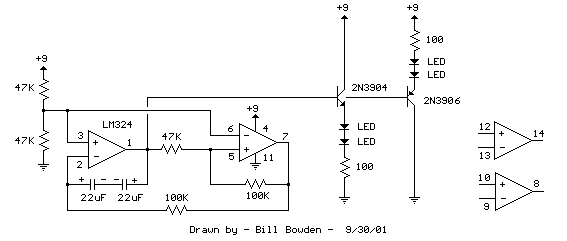

bloody-orc said:
The fading circuit uses a condensator that is banned now because it used very strong radioactive material for its heater to evaporate then condense kryponite. Try the circuit with a capacitor instead, it might work.
You won't find a 30uF capacitor, which was a common condensator value so use 33uF instead. The circuit reverses the polarity of the capacitor so if a supply voltage higher than 5V is used, two polarised capacitors should be used in series with opposed polarities.

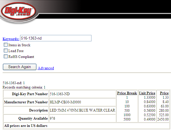

I got some excellent but fairly expensive ultra-bright blue LEDs by Agilent from Digikey or Newarkinone. Agilent is a spinoff of Hewlett-Packard and are American-made. You get to select the beamwidth, brightness range and tint range. The ones I have are all exactly the same, like clones.
Cheap Chinese LEDs aren't reliable, have different brightnesses and tints. Usually they focus them into a very narrow beam to be bright. I bought cheap Chinese LEDs to try and some didn't work and others were completely different colors.

Digikey carry about 20 manufacturers' LEDs. Agilent changed their name again to Avago or something. Here's the one I recommend:
ok im going to order these leds today

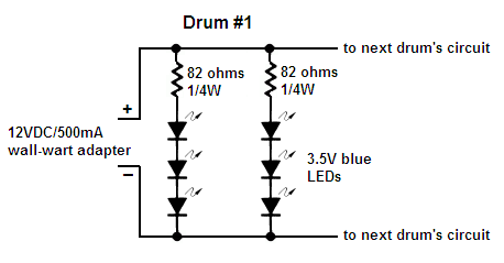

what voltage will i need for this circuit?
i want to wire it so it will be like the pic below
i wont hard wire this all, ill have it so thres a plug on each drum so i can take them off the stand and put them away if needed
the pic: yes those are diode symbals but just say they are LEDs for now
each blue point is a solder
theres a switch at the bottom and a power supply
i dont know what voltage lights these LEDs up because it does not say on digikey
so i need to know what voltage ill need to power this up
i also want to run it on a transformer so i can run off 120V
My blue Agilent LEDs are about 3.2V at low brightness and nearly 5V when pulsed at 90mA for extremely high brightness. You could wire 4 in series and in series with a 300 ohm current-limiting resistor and a 20VDC supply.
Your LEDs would burn out one-at-a-time within milliseconds.
They are all slightly different and the one with the lowest forward voltage would take most of the current from the supply and burn-out immediately, followed by the rest of them.
LEDs aren't lightbulbs, they are diodes and diodes don't work properly when they are in parallel. LEDs need a current-limiting resistor.
Do you have 4 drums and you want 6 LEDs in each drum?
I selected a 12VDC wall-wart adapter because it is common and cheap. You will have difficulty finding a 20V one.
My circuit has only two wires between the drums, yours has more.
