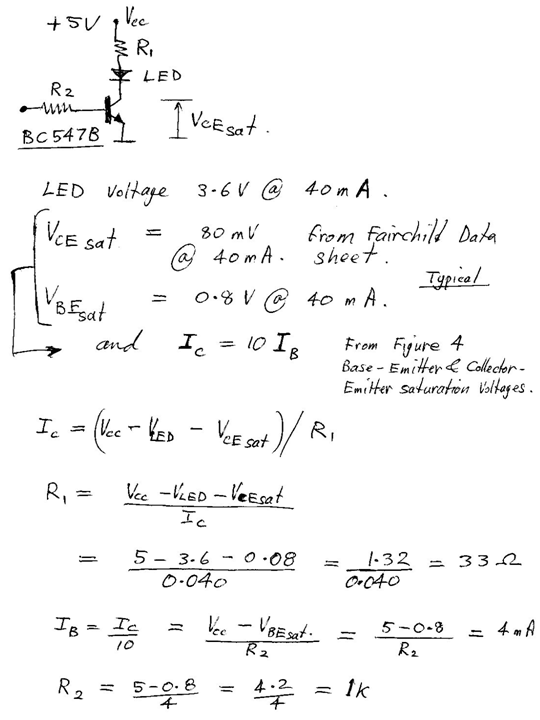

You need to study the transistor more.
You can't connect 12V directly to the base, it would blow the transistor sky high.
The base - emitter voltage must be limited to around 0.6 ~ 0.8 Volt.
The emitter emits charge carriers, these are attracted by the charge in the base-emitter region, most flow across to the collector (which "collects" them) and become collector current. The remainder recombine with charge carriers in the base region and become base current.
The relationship between base current (Ib) and collector current (Ic) is
Ic = Beta * Ib where Beta (otherwise called hFE) is the transistor's current gain.
I wrote the attachment for someone else recently. The LED will glow when 5 Volt is applied to the left hand end of R2.

Did you look at what I posted?
Using your terminology, the Main Supply is what I maked as "Vcc"
The "switch current" I assume is the current that causes the transistor to switch the collector current on. If so then this is the base current which is due to the voltage applied to the left hand side of R2.
"when switching current is applied the electricity travel out of" the collector.
However, the current direction is from positive to negative (conventional current) so, in this case, the collector current goes into the collector.
In short, if you apply 5 Volt to R2, collector current flows through R1 and the LED then from C to E.
Note that in Ljcox diagram, he is using an N-P-N transistor for illustrative purposes. Make sure you are also, as using a PNP will cause all kinds of grief while you are learning.

The value of the resistor in series with the base sets the amount of base current. A transistor has a current gain of about 230 (for a small transistor), so the base current is 1/230th of the collector current then you don't need a lot of base current.
Use a base current of 1/10th of the collector current to turn on the transistor as hard as it can.
What do you want to do with your transistors?
You can use them as amplifiers or switches.
When using a transistor as a switch it needs to be saturated (be turned on as much as possible (hee hee that sounds a bit dodgy :D), the base current should be 1/10 of the collector current (as audioguru says).
