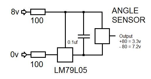

I need to interface a voltage from a angular output to an older system.
The system provides 8v, BUT!! there are two 100 ohm resistors on the 8v rail and the 0 volt rail.
The inclinometer needs 5v... Said output ranges from 0.6v ( -80°) up to 4.4v (+80°)..
I will sit the device so I get a nice 90° output... The system requires a 3 ~ 4v input 3 being 90° and 4 being 0°..
with a bit of playing space 1 have chosen 3.15V = 90° and 3.85 = 0°..

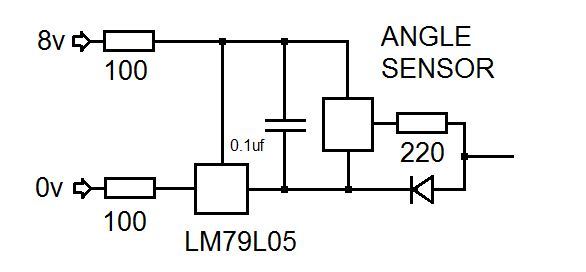

The 100 ohm resistor causes the output of the LM79L05 to be 2.85v. No matter how attenuate the output I cannot get a clean 90° output between 3 ~ 4 volts.. If I use a 220ohm resistor from the output to the system and place a diode to"prop" it up I get somewhere near, but diodes aren't the best when it comes to temp stability.

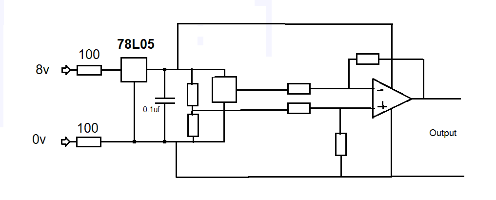

Please excuse my quick scribble, but I would do something like this using a 5v rail to rail op-amp, I suggest an MCP6042.
I would put the regulator in the +ve supply line, if only because my brain works better that way.
The voltage divider across the 5v supply could be made adjustable to set the correct "zero" point.
The resistors around the opamp could be used to set the gain, and/or a potentiometer on the output could be used to reduce gain to give the desired span.

I must admit I was also steering towards a 7805 as the 7905 doesn't really do what I want.
There is little room but I have little smd mcp602 5 pin devices, its the whole host of resistors I'll need to fit in!!

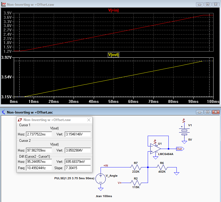

Here's the LTspice simulation of a circuit that (I think) gives the offset and gain that you want.
  • Non-Inverting w +Offset.asc
I don't think I can get away without the opamp.
You possibly could if the system load resistance is high enough and the inclinometer output can drive a lower impedance version of the three resistors (say each one reduced to 5% to 10% of the values shown).

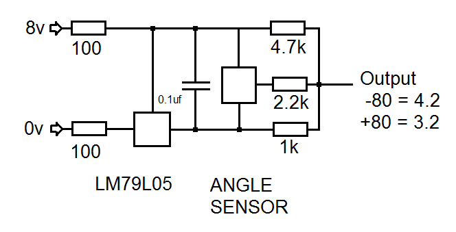

Messing with Carls equation... I finished up with this..
It gives a margin of error so I can give them a elongated slot to reproduce the old one.. I have asked them to send one of the old boards as I don't think I need to buffer with an opamp as there is a voltage follower on their board..

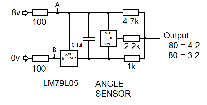

What point is used for common for the output?
If you use 0V then the output will shift with the 8V voltage value.
Is that acceptable?
Using a 78LO5 would not have that problem.

It was harder to get anything that way... I knew I was nearly there... Your answer was a potential divider across the (now) 5v rail.. It works out 2.85v to 7.85v with reference to ground..
Labelled the parts so you get more of a feel.. I will test this on a system as soon as I get it ... I'm more than confident it will work.. Just to stop any 0v confusion... I only have access at points A , B and OUTPUT so there is no 0v.. This is to replace an existing angle sensor that is now defunct!

So which point is signal common for the existing circuit?
If it's 0V or point B then you have the problem I noted with the level shifting due to any voltage change at point A.

Tell me about it.... The original angle sensor was cmos so a smight easier to interface... This device is 5v ±0.25v, so causes problems..
The first one
And now
Even the first had issues, but this is next to impossible..
My point is, I believe you need to use a positive regulator, such as the 7805, so that the ground reference is the 0V line, and then use a circuit similar to what I posted.
Otherwise your level shift voltage will be affected by the 8V voltage level.
Fortunately for me the 8 v is the more stable... and as 3v is the low ACD reference point a LM7905 gets me closest! If I use a LM7805 the high voltage will be about 1.4 v above the high ADC reference point.. And you keep forgetting... I have no 0v..
