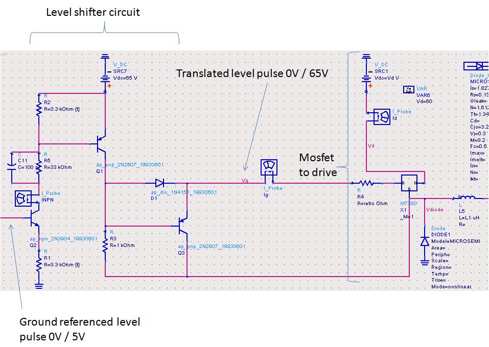

Hello,
From the output of a low side driver (0V / 5V) I need to make a level translation to get (0V / 65V) at the input of a N type MOSFET.
I tried with the following circuit using general purpose npn et pnp devices from motorola, it's really slow but it works. (see included file )
This circuit must be as fast as possible, with minimum number of components. Could you give me an idea to do a faster circuit?
thank you

that is a typical gate driver and practically the fastest.
if you really want, you may look into dedicated driver ICs.
...This circuit must be as fast as possible, with minimum number of components. Could you give me an idea to do a faster circuit?
What is the value of R4? R4 and the gate capacitance of the FET could well be the dominant slew-rate limiter.
R4 value is 10 ohms.
millwood, I use a fast low side gate driver (el7457) before this circuit level translation.
The level translation makes the global circuit slower.
If I use NMOS end PMOS in totem topology? what do you think about that?
10ohm is about the high-end of the range.
is it turn on too slow or turning off too slow? this should be good for a few hundred khz.
if it is much faster than that, it may require more work.

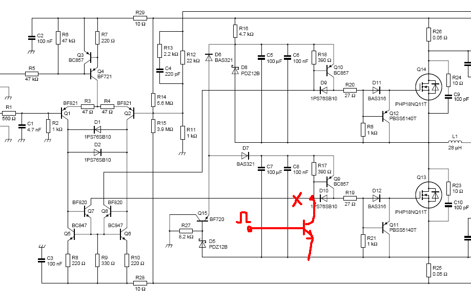

take a look at the attached schematic. it is from a Philips application note on their Class D amp running at 400khz. the two mosfets are driven by two discrete gate driver. the low side consists of Q7, Q9 and Q11. When Q7 turns on, it turns on Q9 which charges up the gate. When Q7 turns off, it turns on Q11 and drains the gate charges.
I penciled in a red npn in place of Q7 as your signal input.
if you go n-channel and p-channel, you for sure w ill need a gate driver of high current output to overcome the gate capacitance - so it may not be more advantageous to you.
I would stay with a discrete or with some dedicated (low-side) gate drivers. try microchip or TI for some.

Your red NPN needs current limiting resistors in series with the collector and the base.

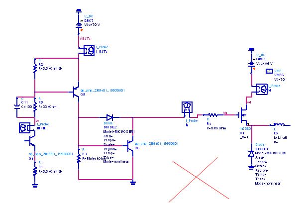

It seems that I don't have to connect the collector of BJT PNP Q6 to the MOSFET source, in contrast with the picture that you post Millwood.
(See attached picture)
If I tie, the circuit doesn't work. Why? Do you have an idea?
