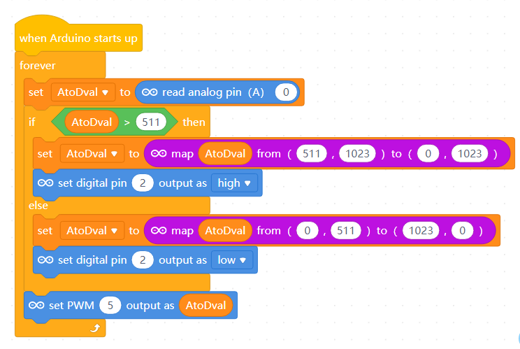

Simplest method for Analog Voltage level-inversion
This would be the code change to add the direction output (pin 2) -
The above no hysteresis. easy to add as well in code.
