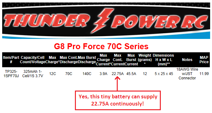

Every battery is different.
Some need a low charge current.
Newer Lithium batteries can charge in a few minutes with a high charge current.
Here are the spec's for the latest electric model airplane Li-Po 325mAh battery cell. It can be charged at 3.9A.
