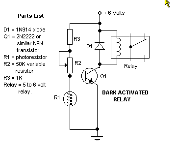

Here in my ckt i am not using relay instead want to make white led to be ON when it is dark.It worked but my problem is the output of the transistor is very low(i.e 2.5v) so the led is not brighter. I need at least 4.5v at the output. what kind of ckt will be needed to provide 4.5v at the output in order to make white led to be brighter.plz help me.

So you have connected an LED in place of the relay coil.
What is the forward voltage drop of the LED and what is the value of the series resistor you have connected to the LED.?
series resistor is 120 ohm and the forward voltage drop is approximately 2v. it cannot be turned on with a single 1.5v battery.
The circuit diagram shows a 6V supply.

I think he means he estimated the turn-on voltage @ 2V because it didn't turn on at 1.5V ( 6V - 4.5V measured at the collector )
Measure and post the values of R1, R2, and R3. Measure R3 in darkness; just cover it with something opaque. Post the values for us and we can better analyze your circuit.
No LEDs will work off a 1.5V battery without a boost converter.
Well I lied some infrared LEDs might light dimly but you can't see them anyway.
