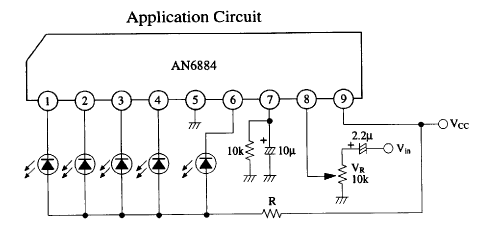

Lately i have been thinking that my computer case is kind of, well, blah. I love music. And, like just about any other teen, i love music with A LOT of bass. My favourite song is "I'm gonna love her for both of us", by Meat Loaf, who just so happens to be the person i have as my avatar. Anyways, i also love light. You know, like in a live concert, they have light shows. I want to make some sort of circuit that flashes LEDs WITH the music. Sure, an equalizer would be cool, and then have the LEDs flashing like that, but i am looking for some type of circuit that would allow me to send stereo(or even better, 5.1 surround sound) into it, and it would flash the LEDs to the music. Does anyone have any ideas? I don't really need this circuit that bad, but it think it would be cool to put into the 2 5.25" drive bays that i have free.

do you want something like a spectral display ?
then split the signal using multiple BPF and give each of them to lm3914 like ics
Sure? What is a spectral display? I have an idea, but i am not for sure.

I have never seen that circuit on his site before. Hmm, it must be one of the new ones. :) No. I don't much like that one. Especially if the circuit has to be recalibrated every time the volume changes. I mess with the volume all of the time. Thanks though! :)
That circuit has mistakes anyway. Look at the input pin 8 of the middle LED driver. It is grounded. Look at the ground pin 5 of all LED drivers. They are connected to the output of the middle filter circuit.
I wonder why the circuit uses a Panasonic LED driver IC?

The LM3914 has a range of 20dB which isn't much.
The LM3916 has a range of 23dB which is still not much.
The LM3915 has a range of 30dB which is quite a lot and is logarithmic to match your hearing's response to loudness.
They are just a dim blur without the Half-Wave Peak Detector simple circuit (on the datasheet) added to their input.
