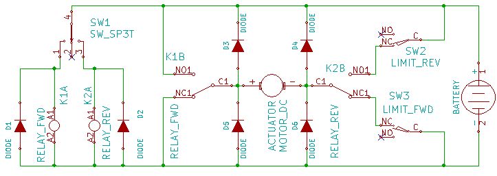

this is what I would do:
you get your 3-pos momentary switch as control input.
there are two relays and two limit switches to handle actuator current and stop it at FWD or REV limit
Thanks for that, Panic Mode. However, i found a way to do it:
David
you are welcome. i can't see your attachment but as long as it works, you should be fine. important thing about such circuit is ablity to back off from trip position. for example if you trip Forward limit. you must not be able to continue running forward but you also must be able to go back.

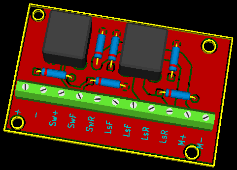

you can put it on PCB too:

i guess that version is not quite final then ;-)
if you energize relay on the left, motor will not run unless the switch is on (to bypass diode you inserted, because in this case diode is reversebiased).
