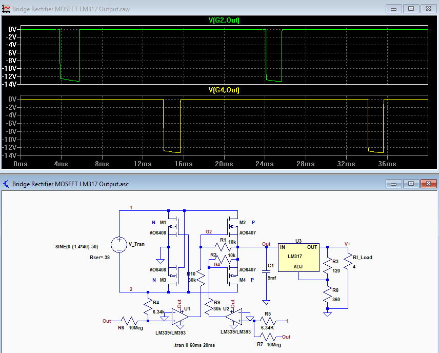

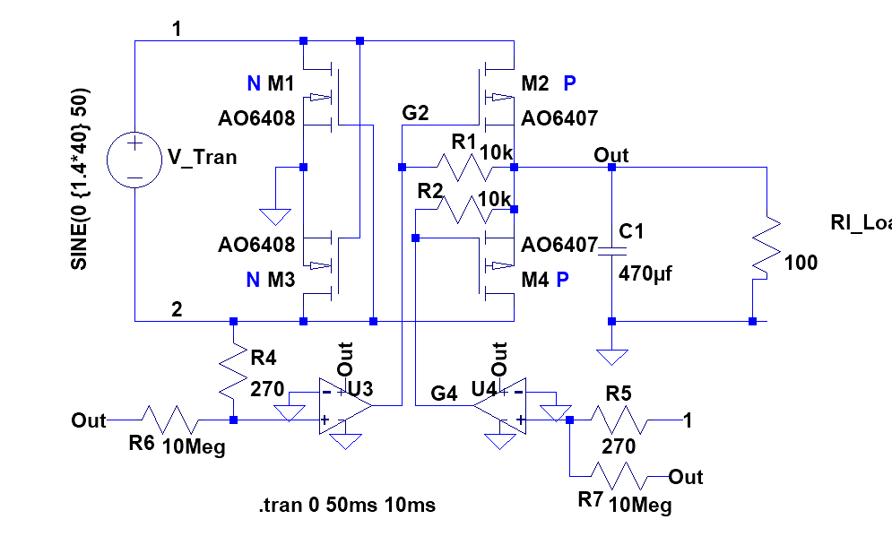

For the attached schematic I need to limit the gate voltages for the N/P Fets. For the N this is simple however for the P gates the voltage swings to ground via the comparator. Assuming a Vcc of 20V created by a resistor/zener between Vout and GND, what's the correct method to ensure the comparator swings between Vout and Vcc?

You can limit the gate voltage by putting a resistor in series with the comparator output.
For example, a 10kΩ resistance would cut the maximum gate voltage in half.
Ah, you've took it to be a N -channel, it's a P so the gate voltage can't be sunk lower than Source - Vgs rating. When the comparator drives it to ground, that's a problem.
No, I know it's a P-MOSFET.
The added resistor creates a voltage divider that reduces the P-MOSFET Vgs voltage, as you want.
As I noted, an added 10kΩ, with the gate-source 10Ω resistor, reduces the ON Vgs voltage by 1/2.

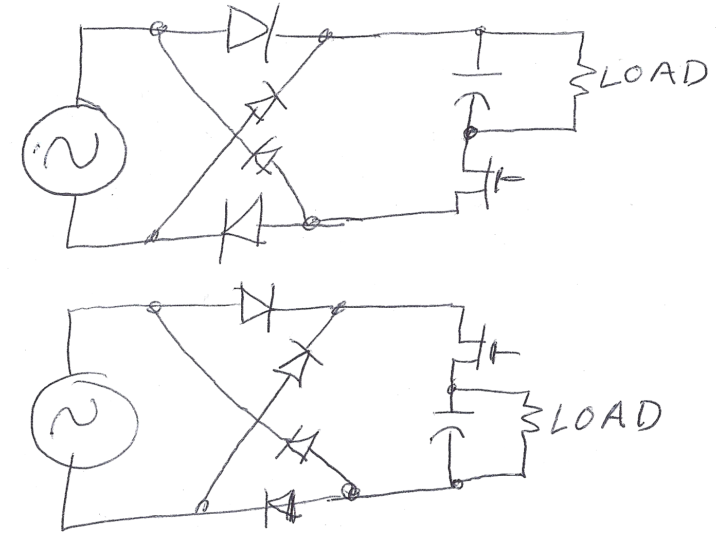

I think the goal is to; get power from a transformer and regulate a DC voltage.
Here are two simple versions.
It's not a regulator.

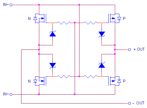

Dropping the gate voltage by half isn't a solution. With a P-channel FET the max gate voltage is the delta between the drain and Vgs rating NOT ground and Vgs rating (unlike N-channel).
So if 40V is applied to the drain and the Vgs rating is 20V then the gate must not drop below 20V (i.e be shunted to ground).
In the picture I've attached you can see how the P-channel is protected.
The issue with the active design I'm using is the comparator swings the gate voltage to ground.

Here's a simulation with 30kΩ resistors in each comparator output.
That reduces the maximum Vgs of both MOSFETs to <14V.
But note that this MOSFET bridge has very little efficiency advantage over a Schottky diode bridge for a 40Vac input.
It adds a lot of complexity for very little gain.

For 6V AC.
You're right on the resistors and yet I tried that first and it didn't work in real-life. There's a lot of overshoot going on causing greater efficiency loss via shorts.
I created three circuits with a large smoothing capacitor and fixed wire resistor to compare the efficiency. Measurements by oscilloscope:
1. 4x 5819's - 5v - 5.5v (5.25v average)
2. semi active, IRF7103: 5V - 5.8V (5.4v average)
3. active, DMHC4035LSD, LM393: 4.7v - 5.4v (average 5.278v)
This was with much faffing to the above circuit, which especially requires two 473 capacitors between the resistor dividers and ground. This may be specific to the DMHC4035LSD characteristics. I found the LM393 was overly sensitive to Vin chatter which would cause false outputs to turn the FET's on. Looking at it, it would probably work to use a boost for stable voltage to the comparator.
