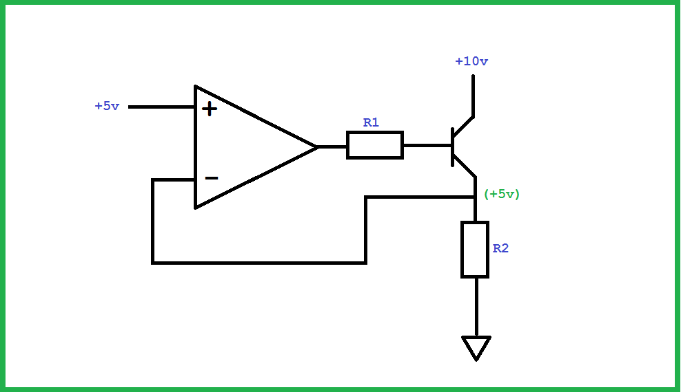

OpAmpTransistor-1.pngHi again,
Ok very good :)
I'd like to turn now to another circuit example.
We start with a transistor, NPN type, lower power say less than 1 amp collector current rating like a common 2N4401 or really even the common 2N2222 or similar.
This device is non linear. In fact, when we look up the definition of non linear we should see a picture of this device :)
Now we connect the base through a resistor R1 say 100 ohms to the output of an op amp. We connect the collector to Vcc. We connect the emitter to a resistor R2 say 100 ohms, and the other end of the resistor goes to ground (R2 is the 'load'). We then connect the op amp non inverting terminal to a stable +5v reference, we connect the inverting terminal to the emitter of the transistor. (Heck i couldnt resistor drawing it, see attachment).
This circuit is a linear voltage regulator. We started with non linear components and ended with something we usually call linear. Is it really linear? Probably not because if the power supply varies from say 7v to 20v we get an output that is +5v regardless. But we usually call it linear anyway to distinguish it from a switcher. So we have:

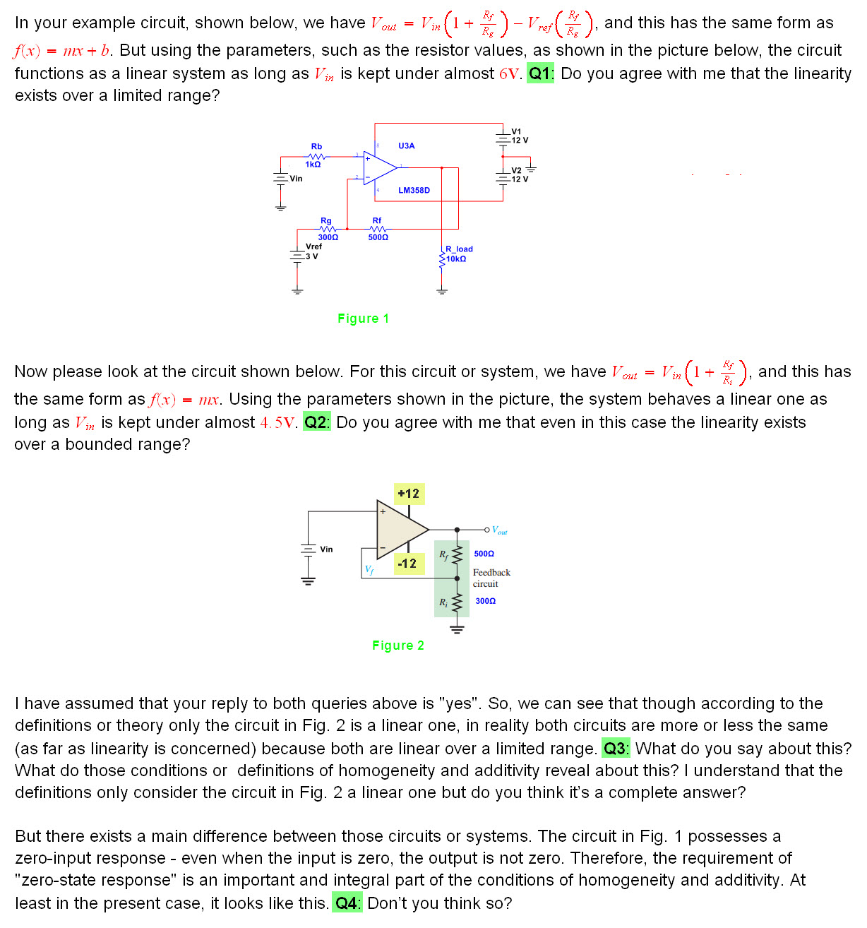

Now I would like to clear only one last thing about the circuit in Fig. 1 just out of curiosity. Steve has advised me not to consider it a linear system even if it looks like one because it can get me into trouble besides creating communication problems for me. But I would like to know what specific issue(s) which can crop up at some point if I start considering that circuit a linear system without worrying about anything and forgetting the fact that it's not a linear system in view of the definitions of the linearity. Thank you.
Regards
PG
The issue is you can get the wrong answer by applying linear system theory to a system that is not a linear system. Linear system theory begins with the concept of superposition. So, superposition will not work in Fig. 1., if you try to apply it. We could also talk about other linear analysis tools too, but why go any further? All linear analysis tools rely on the principle of superposition. Superposition is a key concept we use to simplify problem solving, and blindly applying superposition to a system that you have not verified is a linear system will give you the wrong answers if that system turns out to be nonlinear.
Take the system Vo=g Vi + k, and let Vi= sin(t). Here we see Vo=g sin(t) + k. Now let Vi=t. Here we see Vo=g t + k.
Now, someone asks you what the output will be when Vi=sin(t) + t. You decide to use superposition because you believe the circuit is linear. So, you say the output will be Vo=g sin(t) + g t + 2k. But, the correct answer is Vo = g sin(t) +g t + k.
Now, someone asks you what the output will be if Vi=A sin(t). Rather than solving directly, you decide to use scaling because the system is (so you think) linear. Your answer will be Vo=g A sin(t) + A k, but the correct answer is Vo=g A sin(t) + k.
