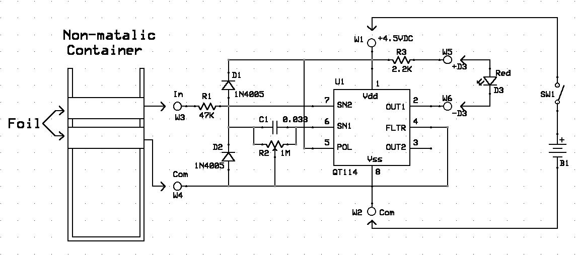

Yes, it will still work with plastic containers. As long as the container is an insulator (Not metal) and the liquid is a partial/full conductor, the capacitive method should work. The weight method will work with any type of container or liquid but the sensor will be more expensive than a couple of strips of foil.
It depends on what interface is available on the computer. The choice is really yours: Parallel, serial or USB ports. Either way, you'll probably need a microcontroller do the capacitance reading and communicate the data via one of the above interfaces.

This is a non-contact liquid level detection circuit based on a Q-PROX QT114 IC. Two foil strips are placed around the non-conductive (i.e. glass or plastic) container. The trip point will be at about the top of the lower foil. The output at pin-2 switches from +5v to 0V when the level drops below the trip point. You will need to find a circuit/module/interface that lets your computer detect this logic level change. The pot is used to adjust the IC to the specific foil/container/wire-length dimensions. I've used this circuit to maintain the alcohol level in a 1L lab jar, through a solenoid valve (via a driver transistor) from a gravity fed supply jar. The alcohol was evaporated by air flowing through the jar. I was never able to see the change in level, but the the solenoid would cycle to maintain the level. It's that precise. I can't help with the computer interface, not knowing what program your using. Maybe someone else can help with that part.
Ken
