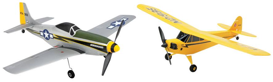

My Piper Cub RC airplane uses 3-channels and weighs 1.0oz (28.3 grams) with the single-cell Li-Po battery cell. It flies for about 10 minutes to 15 minutes per charge. It can do loops. The battery weighs 3.8 grams (120mAh) or 4.1 grams (160mAh).
My P-51 Mustang is 4-channels with ailerons and weighs 1.2oz (34.6 grams) with battery. It can climb vertically and can do fast rolls. It flies for 6 minutes to 12 minutes per charge.
The two airplanes and my new helicopter use the same transmitter and battery cells.
