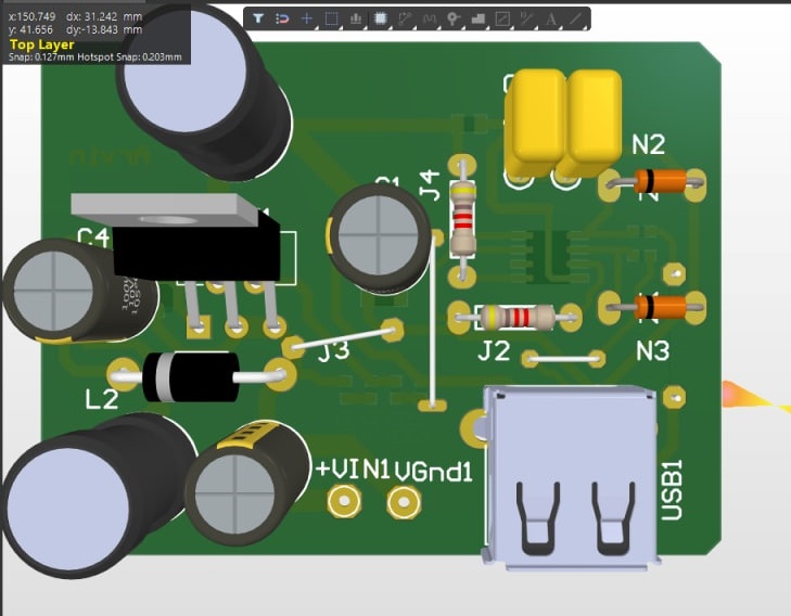

How much is VCEO in LM2596D ?

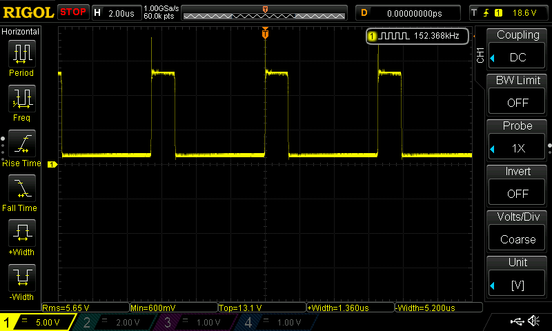

I asked it because I see 23.5V spikes when the switch goes off! my input voltage is 12.5 and out is 5 .
I mention it on this picture:
I saw this method before look like easy. But in my prototype all high frequency and high current joints are soldered.
But you've got long wires, and loads of stray capacitance and inductance, I wouldn't expect it to work terribly well. Layout on something like this is pretty crucial.
The circuit needs capacitance with the minimum series inductance, as close as possible to the LM2596.
The breadboard layout is terrible for that, and the electrolytic capacitors have significant ESR. You need some ceramic capacitors close to the LM2596

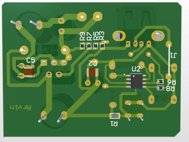

Those are soldered joints. The large PCB serves as a ground plane, then small islands of
one sided PCB placed, sticky side down, to create a connection areas for soldering. So
although I stated it introduces C its relatively small, just a small amount by connection
island sandwich, eg. ground plane | fr4 insulator of one sided PCB | top of the island.
At RF freqs the C is impactful, but at SMPS clock rates not so much.
Ground is outstanding in this approach.

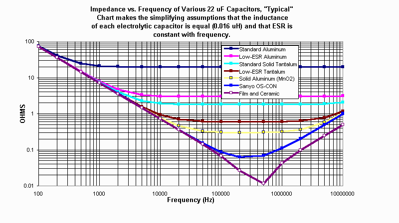

Capaitor ESR matters a lot, various technologies produce various results for same level; of C :
OSCON is polymer tantalum, best in class for bulk caps.
Regards, Dana.

Pls see last picture of post No.17
ok but with long ground wires adding ground shift with 10nH/cm try across to output cap and use braid or litz wire or desolder gauze for gnd wires.
Yes I see large current loops with 10 nH/cm added to your schematic for every jumper and BB ground strip and mutual coupling everywhere resulting in a flyback pulse around 1 cycle at 20 MHz. This is where 2 pF diff. Probes are needed to remove measurement error from inductive ground and probe capacitance.
These spikes are well beyond the servo BW of the regulator yet V=I*ESR+LdI/dt results in spikes . Try to estimate reasons for signals, using what you know.
If you do not have diff probes, use a series cap+50Rs to SMA 50 ohm coax to 50 ohm terminated DSO using same small <2cm loop , you can capture better results with 50% atten.
The value of a ground plane is a low impedance from low geometric ratios of gap height, H to conductor width, W for high current slew rates
