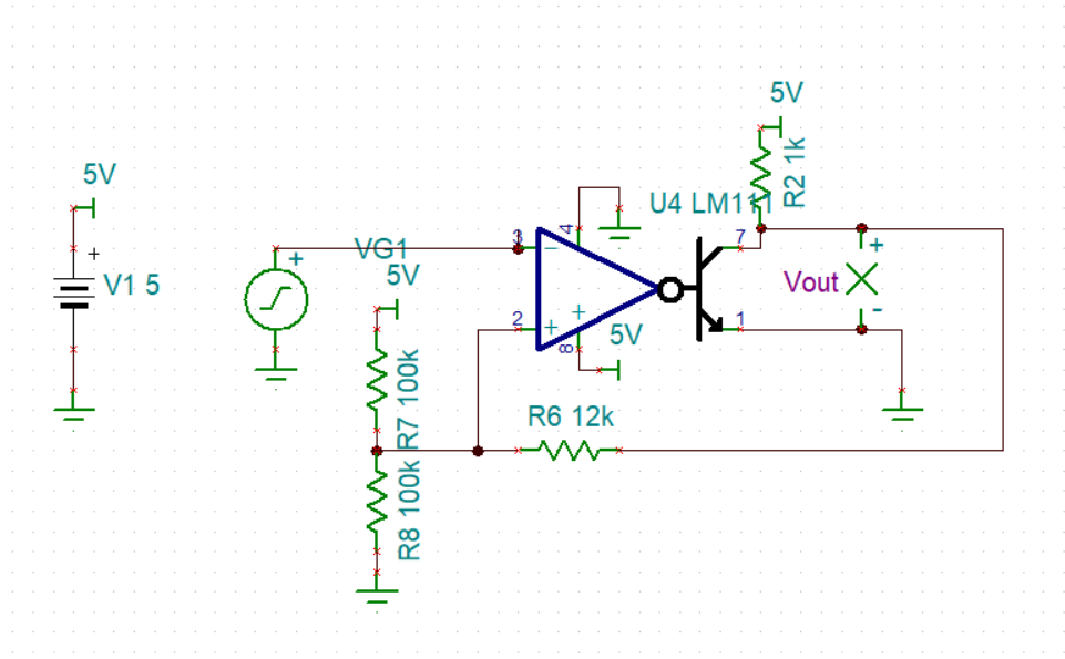

I simulated the circuit below and it works fine but when I tested it in a protoboard it didn't work properly. The output (pin 7) doesn't change.
I tried to put a resistor on pin 1 (the emitter pin of the transistor) and it worked but for my application the output can't be inverted.
I'd like to know why it doesn't work when I measure the collector of the transistor of the comparator. Could someone help me, please?
The input voltage is a sinusoidal signal with amplitude of 2V.

The LM311 has an open collector output. That is, the LM311 output must have a resistor connecting to Vdd.Think of it l
These "output" of these omparitors are more like switch connected to ground. They can not source any current- just sink it.
I used R2 as a pull-up resistor. I can't understand what's going on. Maybe I should change the comparator because I need it for an application with hysteresis and the output of the comparator will be the input of a microcontroller.
The LM311 is not rail-to-rail input or output. The inputs can only be VCC– + 0.5 to VCC+ – 1.5. That makes your effective input voltage range 0.5V to 3.5V.
I think that combined with R6 being too low is causing your hysteresis to be way too strong (and probably out out of input range of the op-amp). The fact you need an extra resistor because the comparator is open-collector makes things a bit more complicated to calculate out. Just looking at the example in this reference design, the feedback resistor is much larger than the resistors in the divider, whereas yours are much smaller.
https://www.google.com/url?sa=t&rct=j&q=&esrc=s&source=web&cd=1&ved=2ahUKEwi4n9zTjOneAhVWIDQIHb8NAvIQFjAAegQIBxAC&url=https://www.ti.com/lit/ug/tidu020a/tidu020a.pdf&usg=AOvVaw227faJAJEbosbS3kaflRu0
No need to read the whole paper. Figure 4 in the paper shows you eveyrthing you need. If you don't want to calculate things out then make R6 one mega ohm and slowly decrease it.
Also...you might want to add some measures to protect the comparator circuit when the signal supply goes negative.
EDIT: Yup. I calculated that when the output goes LO, the reference voltage at the non-inverting terminal goes to 0.5V. When the output goes HI, the reference voltage is 4.5V. So the voltage at the inverting input needs to go above 5V to make the output go HI->LO, and needs to go below 0.5V to make the output go LO->HI. You can see that both these voltages are outside the input range of the comparator (as well as your input signal) so the comparator can't even see them even if your input signal was large enough.
The extra resistor R2 didn't complicate things at all since it just gets added to R6 when the output is supposed to be HI, and gets ignored entirely when the output is LO.

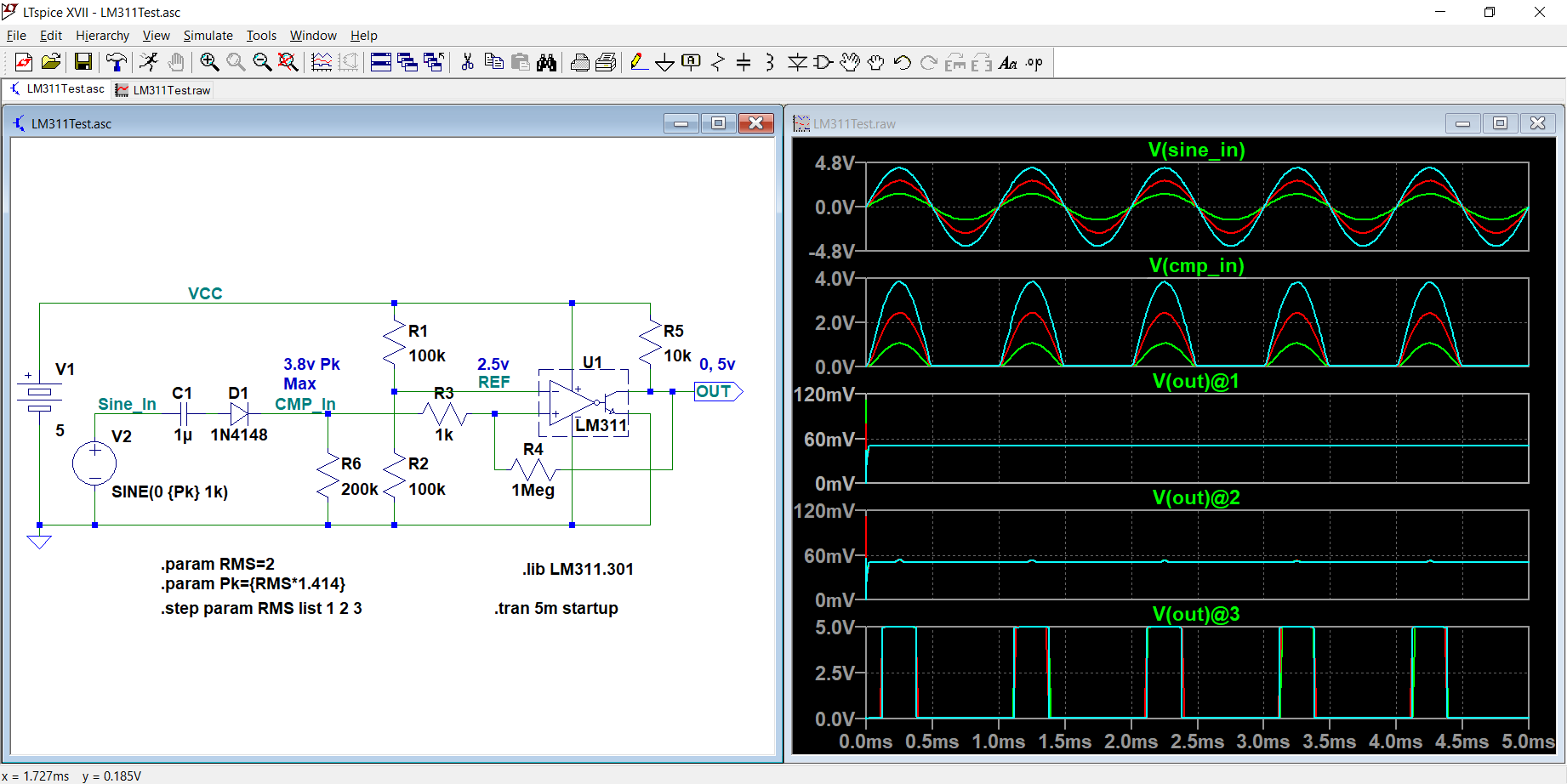

Hi
Is this what you are trying to do?
See Below.
But as mentioned in post #4, the input can only go as close as 1.2v (as in the datasheet) to the +rail.
In the schematic shown, D1 will also cause a about a 0.6v drop of input signal to the comparator.
The feedback resistor R4 will provide about 5mv of hysteresis but can be adjusted.

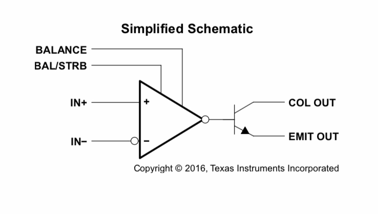

That transistor is integral to the LM311. The symbol is just being explicit.
But yeah, I would just use a push-pull comparator for an MCU.
OK, I'd not seen one drawn with a transistor as part of the symbol before.
It is important on this device because you have access to open collector AND open emitter.
