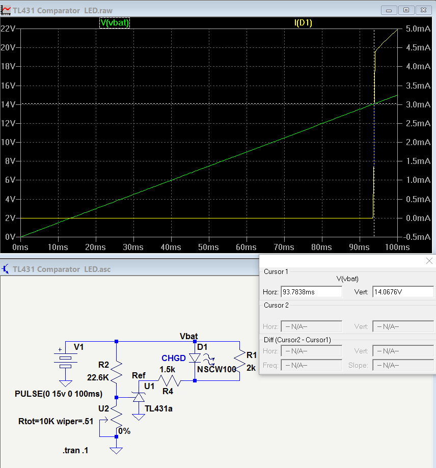

I'd prefer some kind of indicator (mostly just to give me an idea that it's close to charged.
Here's the LTspice simulation of a fairly simple and accurate circuit that lights an LED at the desired charge voltage.
It uses an inexpensive TL431 as both a voltage reference and a comparator.
The pot U2 adjusts the trip voltage (set here for 14V).
If you know the voltage you want then you can use a fixed resistor for R2. The trip point is where the voltage at the U1 input reaches 2.5V.

I love those little 431 chips. Used them in several things over the past years.
Yup, they're cheap, make a fairly accurate programmable zener, and can also be used as a comparator with an accurate built-in reference voltage.
That should work for me.
Thanks.

I like the 431 too because of the same reasons you guys do, the only improvement i would like to see is a lower internal voltage reference.
I agree.
There are a lot of references with a 1.2V output and it would be desirable to have a 431 type circuit with that reference voltage.
How about the ZR431L?
