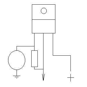

I want to auto. dim a 7-segment display from an LM317 regulator via a light dependant resistor.
The display needs a maximum of 2V (daylight), minimum of about 1V(dark).
The LDR has resistances of about 600Kohm (bright light) to 400ohm (dark).
I don't want to use a 7-segment driver.
I've tried a few resistor combinations, but seem to be missing something...
Any ideas?
Allan.
Several things come to mind. One is that the lower limit of the 317 is listed as 1.25 volts. Another is that you'll need to be working at the very bottom end of the LDR range. How much current/power can your LDR handle?
LDR is apparently capable of 50mW (Nippon ceramic, Cadmium Sulphide).
Spec says 10Lux=50-100Kohm; Dark=5Mohm, whatever that means.
Multimeter says: 600k to 400ohm (dark to light).
Therefore if 'R1'=LDR & 'R2'=220ohm, Vout should be 1.27 to 1.96V, from
1.25x(1+R2/R1))+R2x0.0001 - 0.0001 being max. Iadj...
Unfortunately, my multimeter disagreed.

I don't know where you obtained the formula "1.25x(1+R2/R1))+R2x0.0001" I assume that R1 and R2 form a voltage divider. If this is the case, then v = 1.25 x R2 / (R1 + R2) assuming that R2 is at the bottom and that the supply voltage is 1.25V.
If you post your circuit we may be able to offer more informed assistance.

Len,
I understand the Dark=5Mohm - it's the bit about 10Lux that means nothing to me!
In the picture, the round thing is the LDR, the TO-220 thing is the LM317T & the rectangle is R1, middle leg goes to the 7-segment display, right leg +ve.
With R1 at 20ohm & a 10ohm in parallel with the LDR, I can get the output in the right area (about 1.5V), but obviously with 10ohm in parallel with the LDR, variablility is practically nill.
Allan.

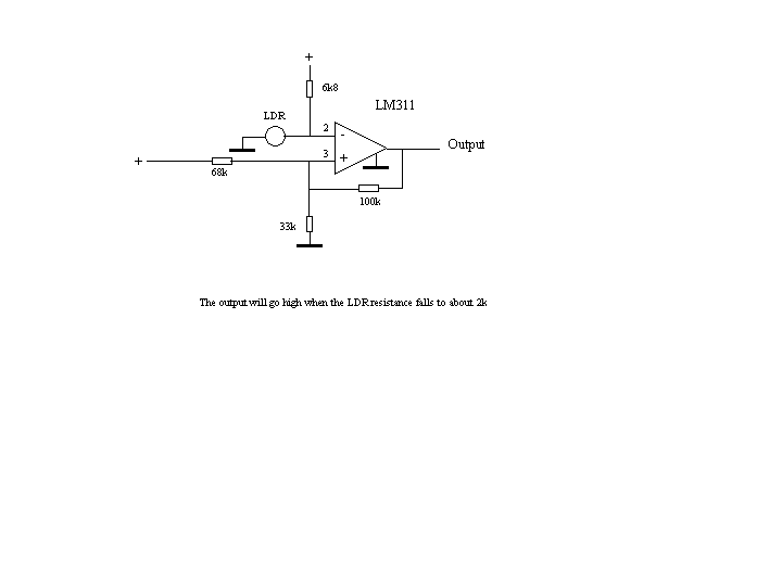

Allan,
Something like this would be a better option
Len

I wanted to use the LM317 with the LDR to adjust the brightness 'steplessly' - not have two brigtnesses & a switchover threshhold, but thanks anyway.
I'd already thought of the 555 route, but an LM317 & one, maybe two resistors takes up less space than a 555, resistor & capacitor.
What you need then is an op amp in lieu of the voltage comparitor.
Move the 100k resistor from the + to the - input and change some resistor values and the output will be proportional to the light input.
The LM317 is not really suited to this purpose
Len
Len,
This sounds interesting, any chance of a (simple) circuit & a suggested op amp?
I'm sure you've gathered, that if it's not plain to see on a datasheet, I'm stuck!
