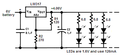

Lm317t
ReallyConfuzed
I have a 6v battery ranging from 5.5 to 6.5v. and it's 4.5AH
I have 16 LEDs I would like to run off it using a LM317T.
Each LED is 1.5-1.6v
What I would like to is run a series of 2 LEDs x 8 paralle.
So each pair would need around 3.2volts.
The symatics on the back of the package for the LM317T are confusing to me. If some one knows how to limit this chip could you put it in laymans terms?
I wouldn't mind if someone wanted to post a diagram of the project. :) But I still want to learn.

If your LEDs are 1.6V then 2 in series need 3.2V.
The LM317 needs to have an input voltage that is about 2V higher than its output and the current-limitinging resistors need about 1V.
So the minimum battery voltage is 6.2v but your battery cannot supply it.
Use a single LED in series with a current-limiting resistor. Then the LM317 needs a minimum input voltage from the battery of 4.6V.
The LM317 can drive a few single LEDs with their own resistor if it has a heatsink.

Use a 5V low dropout regulator with a dropout of less than 500mV. Connect the LEDs in series pairs of two each with the appropriate series resistor.
LEDs need a current-limiting resistor in series with them to prevent them from blowing up.
If the LED is 1.6V then use a 2.0V supply. Use a 3 ohm resistor for 133mA.
If two LEDs in series are 3.2V then use a 4.0V supply. Use a 6.2 ohm resistor for 129mA.

The datasheet for the LM317 says it needs a 0.1uF input capacitor 9use a ceramic disc type) and a 1uF to 10uF output capacitor (use an electrolytic type.
The datasheet shows the simple calculation for its two external resistors to set its output voltage. The resistor from its output to its ADJ pin is 120 ohms and has 1.25V across it so its current is 10.42mA. Then the other resistor is calculated with Ohm's Law. For a 3.2V output then the resistor from the aDJ pin to ground is 187 ohms. If you use 180 ohms then the output voltage is 3.13V which is close to 3.2V. If the resistors have a 5% tolerance then the voltage could be plus or minus 10%.

Now I also have another question about resistors. If I'm using a 1 ohm resistor for each 16 LEDS say 1/4 watt. Can I replace that will a 10w or so 1 ohm resistor and run all the leds off of that paralle? Is there really much of a different there?
16 of your LEDs draw more than 2A which is more current than an LM317 can supply.
If you connect 16 LEDs in parallel and use a single 1 ohm current-limiting resistor then the LEDs will burn out one after the other and the resistor will also burn out. The LM317 will get too hot.
If you connect two LEDs in series and in series with a 6.8 ohm resistor then the current is 126mA and the LM317 can power 8 or 10 of these strings.
The LM317 will need a small heatsink.

This is normal. If you have 3 LEDs running off the 7805/2.2:ohm: they would need between 4.5 - 4.8V across them before they drew their rated current. Since the 7805 can't supply much current with only 1V across it so it's output drops to 4.68V, the LEDs get much less current than the 91-227ma calculated (With only 4.68 from 7805 and a Vf of 1.5-1.6V they would draw between 10-82ma) and the battery lasts longer. Look at the spec sheet for your LEDs, and you'll see a curve that shows the typical relationship between LED voltage and the current through them.
a 4.5Ah battery will supply 0.45A for 10 hours. It might supply 4.5A for 1/2 an hour.
The battery is not supposed to be deeply discharged since then its life is shortened.
You had 4 strings of LED and each string might have been uing 120mA so the total current was 480mA. Then the LEDs would be bright for about 8 hours then get dimmer and dimmer gradually.
I think you will blow up your LEDs. Their current was way more than the 140ma max allowed continuous current.
Measure the voltage across the current-limiting resistor and use Ohm's Law to calculate the current.

The math for Ohm's Law is simple. Current= The voltage across the resistor divided by the value of the resistor. The current in the resistor and in everything in series with it (one LED or many LEDs) is the same amount of current.
Ok, here is the current setup. 2.2 ohm with 3 LEDs x 4. (total of 12) Running off the 5v regulator that is rated for 1A.
The volts across the 2.2 ohm is .32 so .145A x 12 = 1.72A
Now this 7805 chip has Internal Thermal overload protection and Internal short circuit current limit. Even though it is working.
But on the final product I can run 2 regulators to split the load just for saftey.
So it would be 8x.140=1.12A on the LM317 which is rated for 1.5A.
