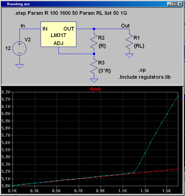

So lets see what happens to the output of the 317 as a function of R1 and the load current.
I make R2 = 3*R1 so as to try to make the 317 put out a nominal 5V.
There are two traces, the Red one is the voltage out with a 100mA load, and the Blue one is with no (1GigaΩ) load, both plotted as a function of R1. Note that for values of R1 above 1.2K, the voltage rises if the load is switched off.
So Scrooge, for values of R1 around 200Ω, do you really think it matters if R1 = 200Ω, 220Ω, or 240Ω??? Especially, if R2 is a pot that you are going to tweak to get the exact voltage you want out.

I do believe D2 is in the wrong place. I believe, it should be across the output.
No.
Look at the datasheet for the LM317. It shows the two protection diodes.
The regulator will get hot if high currents are drawn with Vadj shorted. e.g. regulator set at 1.2V.
No.
With the ADJ pin connected to ground then the output voltage is +1.25V and the output current is drawn by the load, not by the regulator.
The regulator heats normally by the output current times the input-output voltage.
