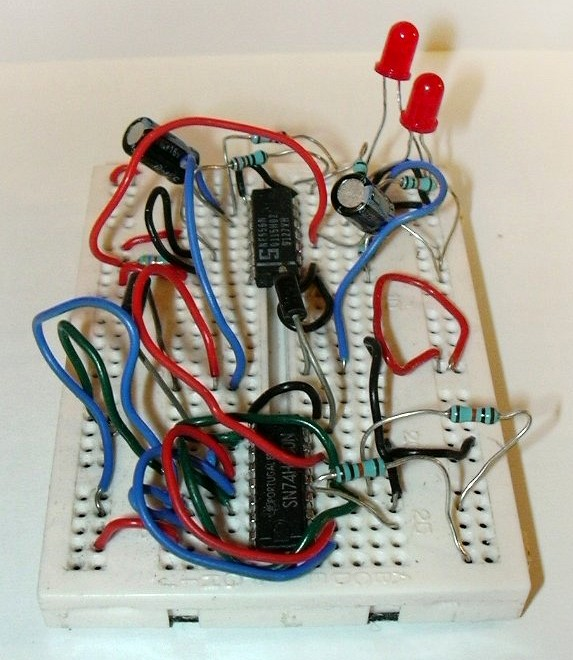

Here is why.
Is that your photo? The Signetics NE556 looks like it has a 1979 date code.
Is that your photo?
No just a stock photo. Kind of a joke. But the picture sums up what I want to say.
I see wireless breadboards too much. Long wires. No bypass caps. Loose connections. Questionable grounds. Extra pin to pin capacitance.
When a part is unstable I first check the PCB layout. Check the grounds. Look at the grounding on the timing capacitors. Long leads, long traces.

In general, the novice doesn't understand that the key to a functional design is a well built prototype.
Every new engineer should spend as much time as possible honing their prototyping skills.
