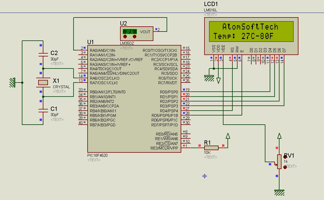

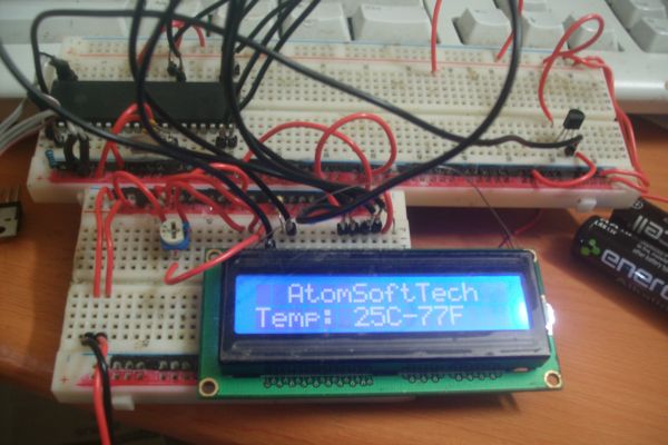

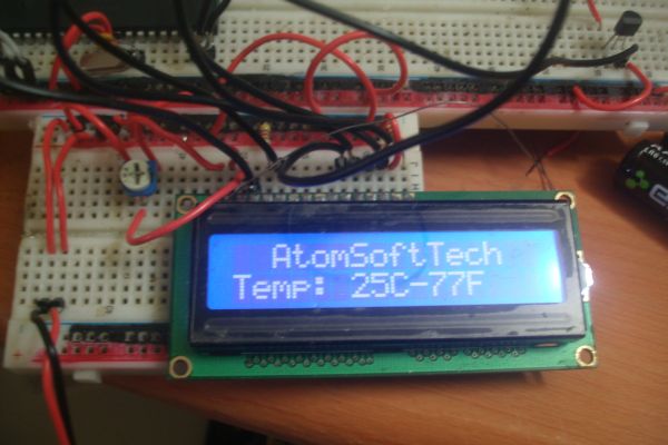

Hey guys i just got my LM35 in the mail and am glad to say its so much easier to use than the LM75 heh.. Here is a picture from ISIS.. It works well live also:
Below the picture is full source code for LCD, LM35 (ADC MANUALLY)
lm35-jpg.34560
OR
LM35_ADC.zip
