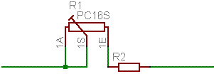

Jay.slovak said:
And I would replace R1 with serial combination of trimer and resistor, so it can be fine tuned.
Dumb question:
If I were to replace R1 with a trimer and resistor as you suggested, how would I connect the 3 leads of the trimer? :?
ptewright said:
Dumb question:
lol no problem :lol:
Try this :D
