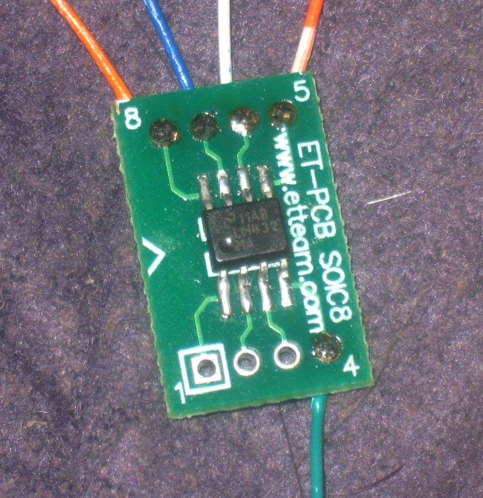

Hello there,
I had been mentioning a way to get rid of the LM358 crossover distortion for years and there's even an app note floating around on the web somewhere. We started talking about this again and some pic's posted showed some nasty crossover distortion so i decided to test it first hand.

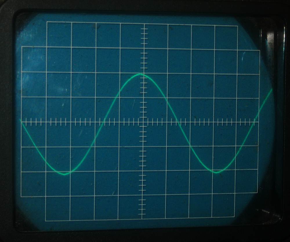

The board picture shows the board itself, minus the resistors used., while the scope picture shows the output waveform at 10kHz, amplitude 2v peak. Any slight distortion at the peak is caused by the frequency generator which uses a non linear technique which is not perfect, so the output wave looks just like the input wave. The gain is set up to be a voltage follower with output connected to the inverting input. The non inverting input has a 10k series resistor to protect the input stage if the power becomes disconnected for any reason, as the wave generator puts out it s own voltage signal.
As you can see from the scope pic, there is no noticeable crossover distortion. This happens with no load as well as any load going to the most negative supply, and i used a 1k resistor as the load for this test. The most negative supply is considered to be the ground reference, and the wave generator is set to have a suitable offset voltage so it can go plus and minus around that level on the input of the op amp.
The wave looks extremely clean near the zero crossing (and i zoomed in too at one point to check) and this is because the output has the resistor to ground.
Note the actual device used was an LM432 SMD package, but according to the old National data sheet it's the same amplifier as the LM358.

Oh datasheet from texas instruments also said LM432 is similar to LM358, lol

The LM358 dual and LM324 quad do not produce crossover distortion when they drive a resistor connected to ground like you did or to the positive supply because then one of the output transistors operates in class-A (and unfortunately gets hot).
Also since they are low power and do not have enough bias current for their class-B output transistors then the slew rate is so low that they have trouble with frequencies above 2kHz when the output level is high.
Your gain of only 1 resulted in lots of negative feedback and your frequency of 10kHz was maybe causing your opamp to attenuate crossover frequencies.

Yes that is correct. But once biased properly the results are easy to see on the scope picture of the actual device and it shows a clean waveform.

Well, we already know that connecting ONLY a load to the output to a central ground (dual supplies) will allow crossover distortion. We know that because it's been tested and scope picture posted in another thread clearly shows crossover distortion.
BUT, the solution is to connect A SECOND resistor from the output to the MOST NEGATIVE supply. The load can go anywhere it needs to go, form output to negative, from output to ground. But without that SECOND resistor there will be crossover distortion. The SECOND resistor is what forces the op amp to work in a more linear class which prevents ANY crossover distortion because then there is no crossover, even when the actual load goes from output to central ground.
So you see the device CAN product crossover distortion, but with an extra resistor on the output (of the right value of course) there is NO crossover distortion anymore because there is no crossover.
