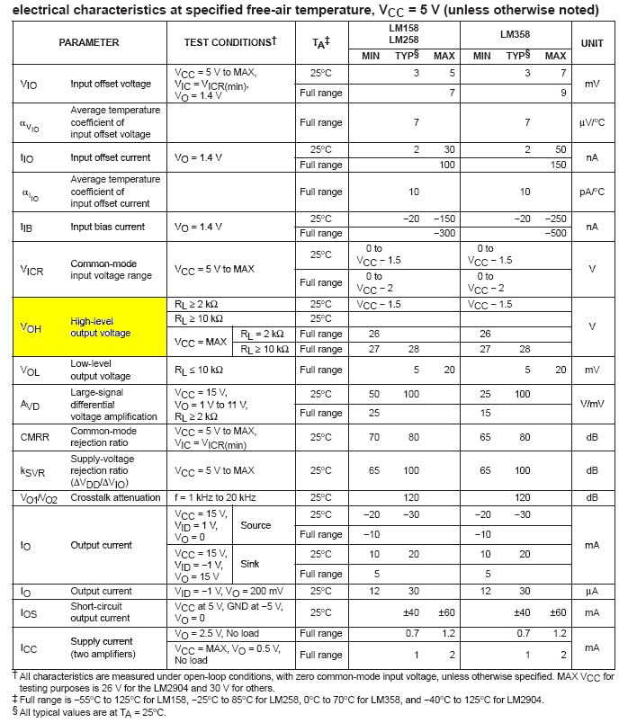

I am working on a temperature controller based on LM35 (Temperature sensor) and interfaced to PIC microcontroller ADC, with 5V as reference for ADC.
To increase the resolution of my signal from LM35, I have added an amplifier -- LM358, with a gain of 11 and supply of +5V and 0V.
My problem is that the output of LM358 (op-amp) saturates at 3.707V. I know that LM358 is not a rail-to-rail Op-amp, but I never expected the output to saturate at 3.707V (when supply is +5V and 0V). I decided to reduce the gain of amplifier so that the output never reaches 3.707V for my application need.
My query --
Where do I get this figure 0f 3.707V output saturation in the data sheet of LM358 (that will help me to figure out such error during design of any other project)?
There is a parameter called "Output Voltage Swing" It has two items in the LM358 datatsheet. Voh is the output high voltage which is always lower than the supply voltage and Vol which is a couple of tens of millivolts.
Note also the "Common Mode Input Range" It is usually specified as V+ minus 1.5 to 2 Volts. Inputs at the rail caus problems also.
Use a seperate 7805 with two diodes in the GND leg which will bump up the supply to the opamp by another 1.4 (ish) volts. Feeding the LM358 with 6.4 volts intead of 5v will get you to that magic 5 volts output (well 5.1 volts).
Here's the relevant spec.

The graph in the datasheet for the LM358 shows that its output gets 1.2V from the positive supply when it sources no current. Its loss is worse when it sources current.

Just power the op-amp from a higher voltage supply.
The chances are, you're running the regulator from a >9V so it won't be a problem.
