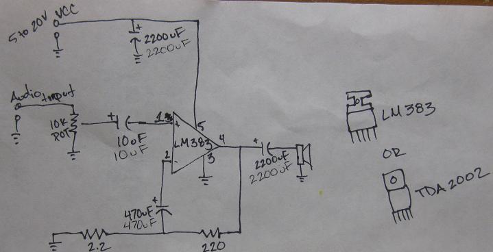

Hi, I when to my electronic store and ask for the LM383 but they didn't have it so they told me that the TDA 2002 is the same thing so I have that using instead of the LM383.
So I build the 7Watts amp with this TDA 2002 but the thing I'm having trouble is that with two nine volts battery it just makes a weird sound but with the one 9V I could hear it, and pretty loud too, but it doesn't sound clear I would describe it as distorted, and I was told that this amp could be power 5 to 20V so if you could tell me whats going on to be able to hear it rite and clear. Well thank you and for any comment.

I assume by 9v battery you mean the little batteries for radios and such like.
These batteries cannot supply sufficient current for a 7 watt amplifier.
A quick look at a TDA2002 datasheet shows that the quiescent current is typically 45mA which will drain your little batteries in no time.
When you try to get some power out of the amplifier, the current drain on the battery will be even higher.
You need a bigger battery.

Your circuit is missing the very important series RC at the output that prevents the IC from oscillating.
Look at the datasheet to see it.

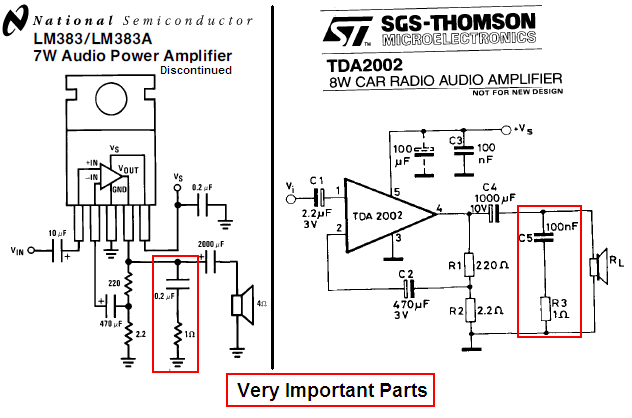

I don't know where you found the schematic that is missing the very important RC at the output of the amplifier IC. It is shown on every circuit on the manufacturer's datasheets of the LM383 and the TDA2002.

Well I was told wrong, cause I been told that I could use two 9V batteries, but what could I power this amp with and can you provide with a link where to buy it or what store and ask for what. Well thank you Nigel Goodwin
By using an 18V supply it will try and take a LOT more current than at 9V, and as suggested small 9V batteries are much too small.

and yeah I been searching for more TDA 2002 schematic and most of them I found that one and I'am missing few stuff and I saw that in my the 10uF to pin one the neg goes to pin one and the one you provide Pos goes to pin one
But I have some question about the pic that you provide since I have the TDA2002 should I build the one with the TDA2002 IC or ether one would do.
And most of the part are the same but I checked and what is 100nf and where does the pos n neg of the battery go to and the audio too.
And does this amp have a potentiometer if so what size, and all the black rectangles are ground correct.
Well thanks again audioguru
what is 100nf?
It is 0.1uF.
where does the pos n neg of the battery go to?
Positive is pin 5 and the supply filter capacitors. The negative of the battery connects to all the grounds and to pin 3.
and the audio too?
The schematics show the input capacitor and the output parts connected to pin 4.
does this amp have a potentiometer if so what size?
A 10k ohms logarithmic audio taper potentiometer is used as a volume control. It voltage-divides the input signal level.
all the black rectangles are ground?
Yes.
