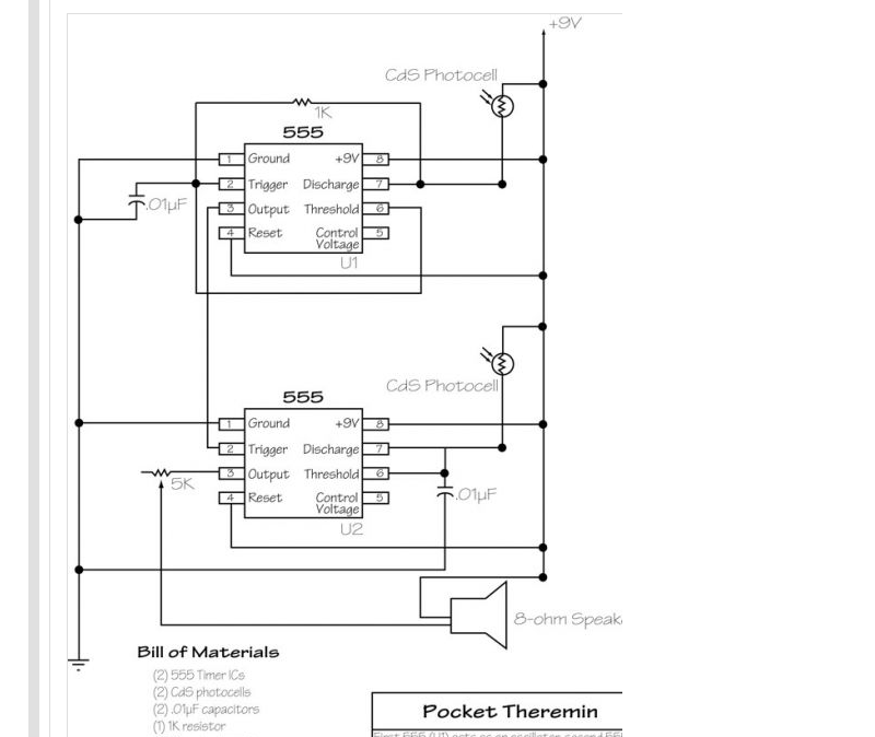

assembled the pocket theremin that shows 2 - 555's

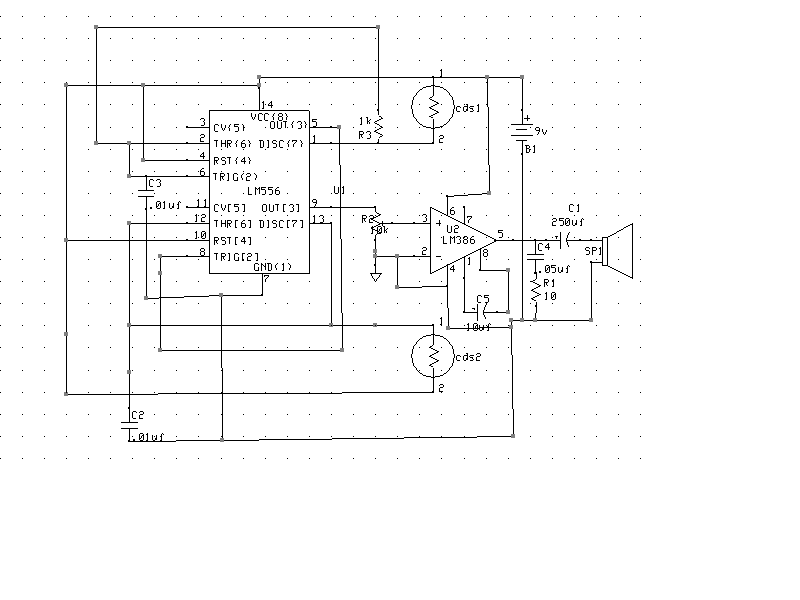

I redid using a 556 and added a LM386 amp.
Not realizing the speaker is connected directly to power (orginal design using 2-555's) so the 555 is sinking not sourcing.
Well I put an LM386 into the mix and realize my error when I have virtually no sound.
Looking at both schematics, how can I insert an LM386 into the circuit??
Thinking about the pot being connected between power and pin 9 then the wiper connected to pin 3 of the LM386??

Your schematic shows a direct short between 9V and ground in the area near the speaker. Also, there is no need for a 10uF cap on pin 4 of the LM386.
The 10uf is from data sheet
short?? if you mean from the negative side of the battery??

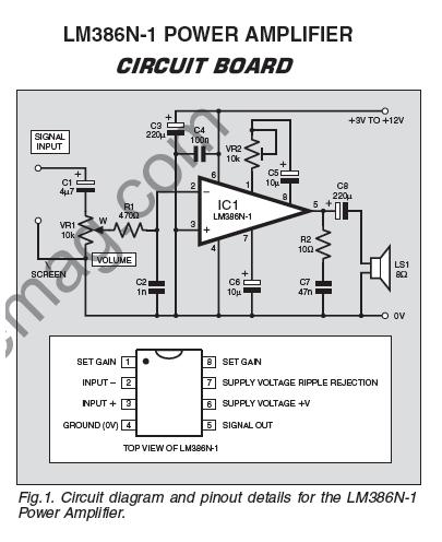

pin 9 from yr 556 -no coupling cap?.... the lm386 circuit as posted by AllVol should work ok 4 eitha the 555 or 556 version of the circuit
Yes, the input of the LM386 amp expects AC, not the very high level DC pulses from the output of the 556 so an input coupling capacitor is needed to feed the volume control.
Get rid of the 10uF C5 that increases the gain of the LM386 amp to 200. You don't need any gain since the output from the 556 is higher than the output of the LM386.
