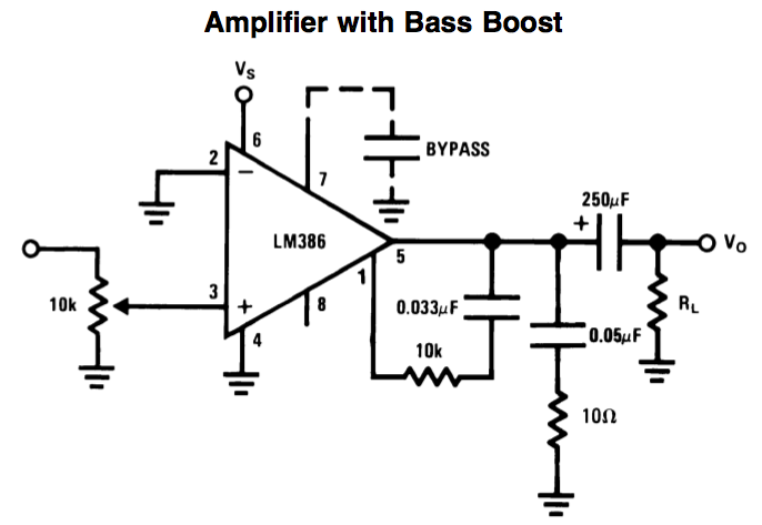

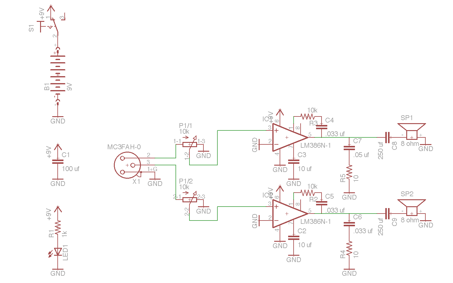

I looked around online to find a circuit for the 386 that could give me the best sound quality to my mini subwoofer speakers, and found one in the data sheet. I copied it into eagle and changed a few things like adding a smoothing cap. and a pot so it could have two channels. I was just wondering if there are any changes that I could make that would improve sound quality or if i could change the two smaller caps, .033uf and .05uf to anything else, since I cannot seem to find them in my local Radioshack. And I was also wondering what type of cap to use as a bypass on pin 7. Thank you.

You mentioned sub-woofers. But the datasheet for the LM386 shows that the peak is at 80Hz and is only 6dB. Important deep bass frequencies below 80Hz are boosted less.
Did you know that the output at clipping is only 0.45W at only 80Hz and is only 0.11W at frequencies above about 1kHz?
You will not feel anything from your sub-woofers with such low power.
The 250uF output capacitor reduces output frequencies below 80Hz. If it is 1000uF then there will be more boost at frequencies from 20Hz to 80Hz.
Thank you, these are the answers i was looking for, but i mentioned subwoofers but they are more like midranges, i took one out of an old stereo that had 2 tweeters and this midrange speaker, and even powered by an ipod, it has good bass response. Are there any other changes that i could make to improve sound quality? And what cap should i use for bypass at pin 7. And I know that the 386 is not great, but it is cheap. Are there any other alternatives that are still cheap yet work as well?
Electronic ICs are very cheap.The TDA2822M amplifier produces 0.8W into 8 ohms with a 9V supply. It costs only $.66US each at Newark today.
You could have much more power from amplifiers that produce 14W each and are designed for cars.
The TDA7240A is a good 14W into 4 ohms amplifier when it has a 13.2V supply. It costs only $2.55US each at Newark today.
The cap on pin 7 can be 100Ufd. @16 volts or more. Increase the 250Ufd. to 1000 Ufd. Both of the small caps could be .047 - a more common value. It would benifit from higher voltage (closer to 12 volts) and batteries with more current capability than the little 9 volt type.

With a 220uF output capacitor the LM386 has a cutoff frequency of 91Hz where the output is half the power of higher frequencies. Frequencies below about 273Hz are reduced.
If the output capacitor is 1000uF then the cutoff frequency is 20Hz and the amplifier is flat down to about 60Hz.
But maybe your "sub-woofer midrange" speakers cannot produce any sound at or below 60Hz.
If it is loud enough for you before it distorts the only thing you will likely notice is the bass boost.
