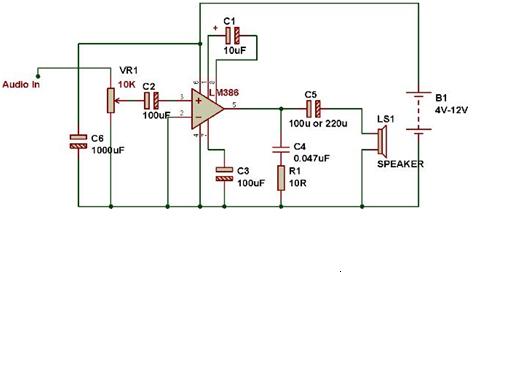

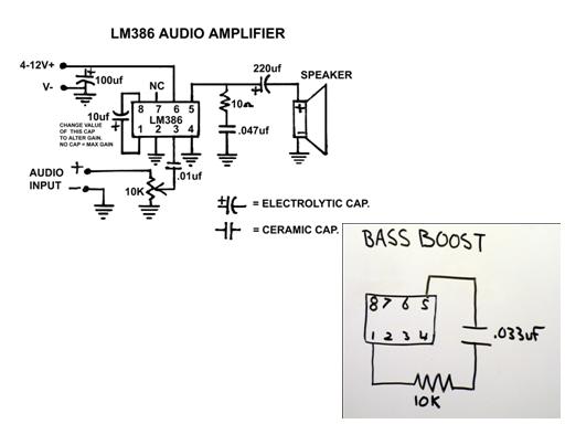

Lm386 amplifier w/ bass boost
hello. i would just like to know if its a good circuit. thanks

The .01 Ufd in the second one is to small, but the boost is ok. I would use the first one and add boost.
The LM386 does not need an input capacitor because its inputs are at 0VDC.
