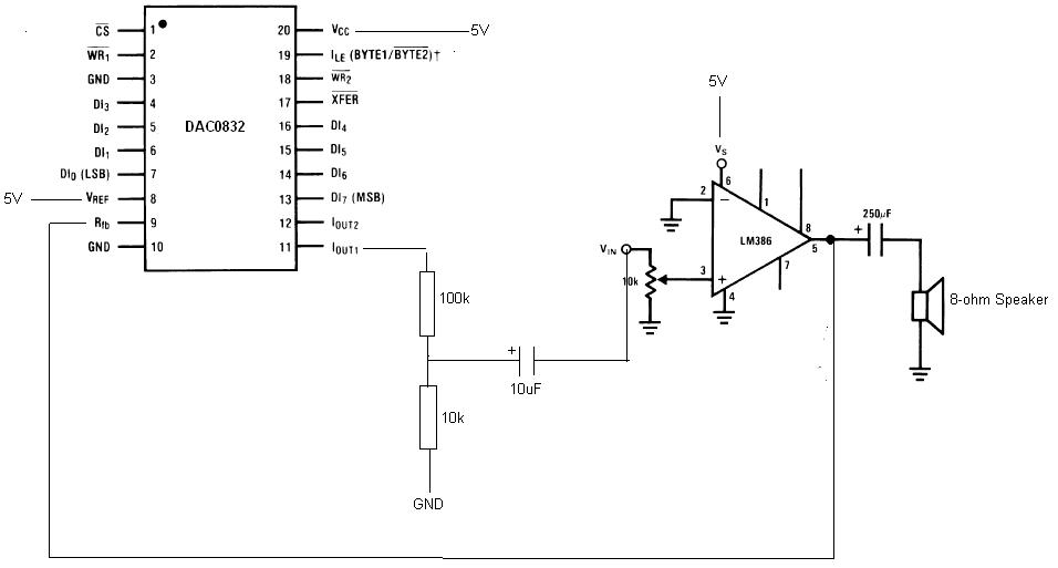

Hi
Sorry for late reply. For the DAC I was using the configuration found at **broken link removed**. This means using pin 8 (Vref) as input to Op-amp, pin 9 (Rfb - feedback) connected to 5V, Iout2 grounded, Iout1 connected to 2.5V (as a replacement for the diode). The data bus pins are interfaced accordingly.
For the op-amp I use the very first configuration (gain=20) found in the datasheet. I feed Vref into pin 3 via a variable resistor in series with a 10uF capacitor served as volume control and low pass filter. All other connections are the same.
When I output a square wave, the sound at the speaker sounds like a square wave, but when it comes to voice, the sound is totally distorted.
Any better configuration?
I would suspect you're overdriving it, why do you want a gain of 20?, all you should need is a unity gain low-pass filter, and probably an attenuator to drop the signal level.
What opamp? The LM386 is a power amplifier, not an opamp. It won't work if you feed a DC voltage into pin 3, because it is designed for its input pins to have 0VDC. Its minimum stable gain is 9.
A filter capacitor with the very high value of 10uF requires a very low value resistor to maker a 2kHz lowpass filter. About only 8 ohms which is like a dead short to the output of the DAC. No wonder it is distorted.
Please post the complete schematic so we don't have to guess how it is.
Hi
Attached is the simplified schematics.
I only drawed the DAC part and the amplifier part. The interface between the DAC and the microprocessor is omitted for simplicity.

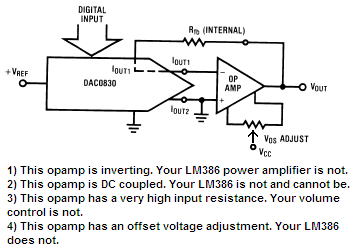

The DAC needs to have an inverting opamp at its output.
The opamp is supposed to be DC coupled and have a very high input resistance. A FET input opamp is recommended.
Your circuit doesn't have an opamp, is non-inverting instead of inverting, is capacitor coupled instead of DC coupled and has a low resistance attenuator instead of the very high input resistance of a FET-input opamp.
Your circuit also does not have a lowpass filter so if it worked then its output would whistle loudly at 8kHz.
