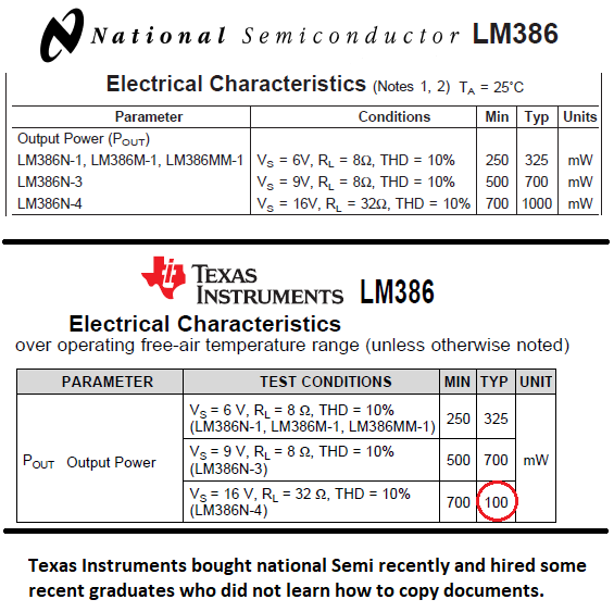

LM386 minimal circuit
The LM386N-4/nopb data sheet says 1 watt
Where can you buy a 32 ohm speaker?
Have you heard how bad 10% of clipping distortion sounds? The volume is turned up too high to make the output power number bigger with lots of distortion.
Yesterday I found an LM386????? in a different package it has a heat sink tab datasheet says 1.5 watts. I wish I had written down the part number. If anyone finds this I want the number I might buy 1 to experiment with.

Don't believe everything you see in a datasheet because NOOB employees get stuff wrong.

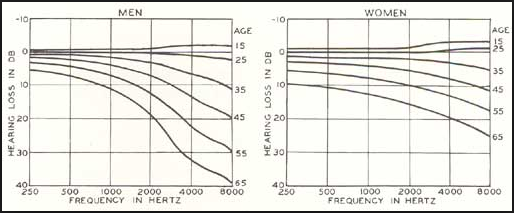

50 years ago when I could HEAR the 8 watt amplifier that I built was LOUD, now I can barely hear it. No way I can hear 1w or 1.5w anymore without ear phones. I am learning new things and having FUN that is what an old retired fossil does. LOL :)
Years ago I built 2 hearing aids with LM386 it has gain control and volume control they work great but 9v batteries dies fast and 8 D batteries are big and heavy. I think hearing aids will work better with improvements like filter circuit to amplifier Hz that I have a hard time hearing. I have been studying filters not sure how to put this together, should filters be on input or output side of LM386.
I bought hearing aids that work great but it would still be FUN to lean how to make the LM386 hearing aid circuit better.

Here are graphs showing high frequency loss of old people. The high frequencies are reduced a lot. My modern hearing aids are tiny and are programmed to restore the reduced high frequencies perfectly. My hearing produces low frequencies perfectly then the hearing aids do not amplify low frequencies.

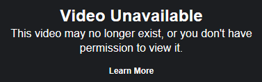

Your video link shows this error:

Because it's a Facebook video that can only be viewed by those cool kids with Facebook accounts. And for a few pennies, the poster can buy a list of all the Facebook members who've viewed their video.
