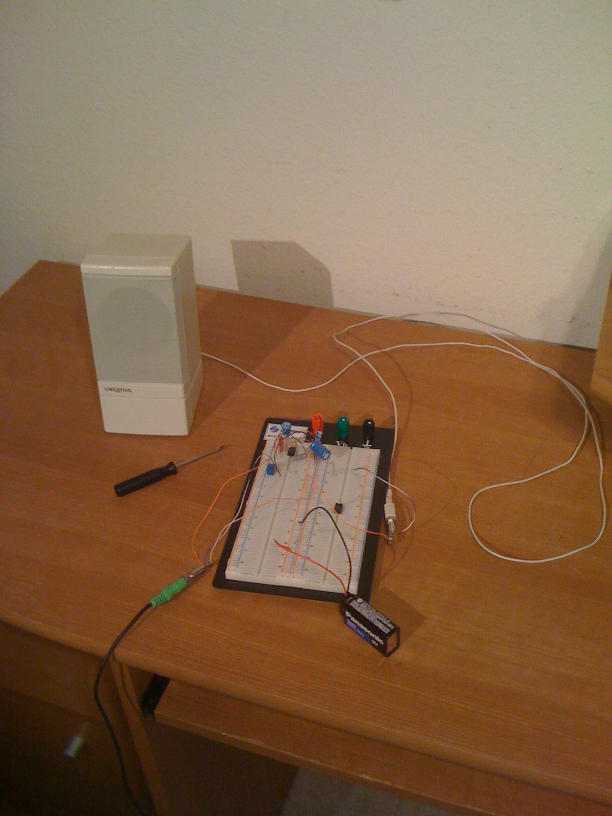

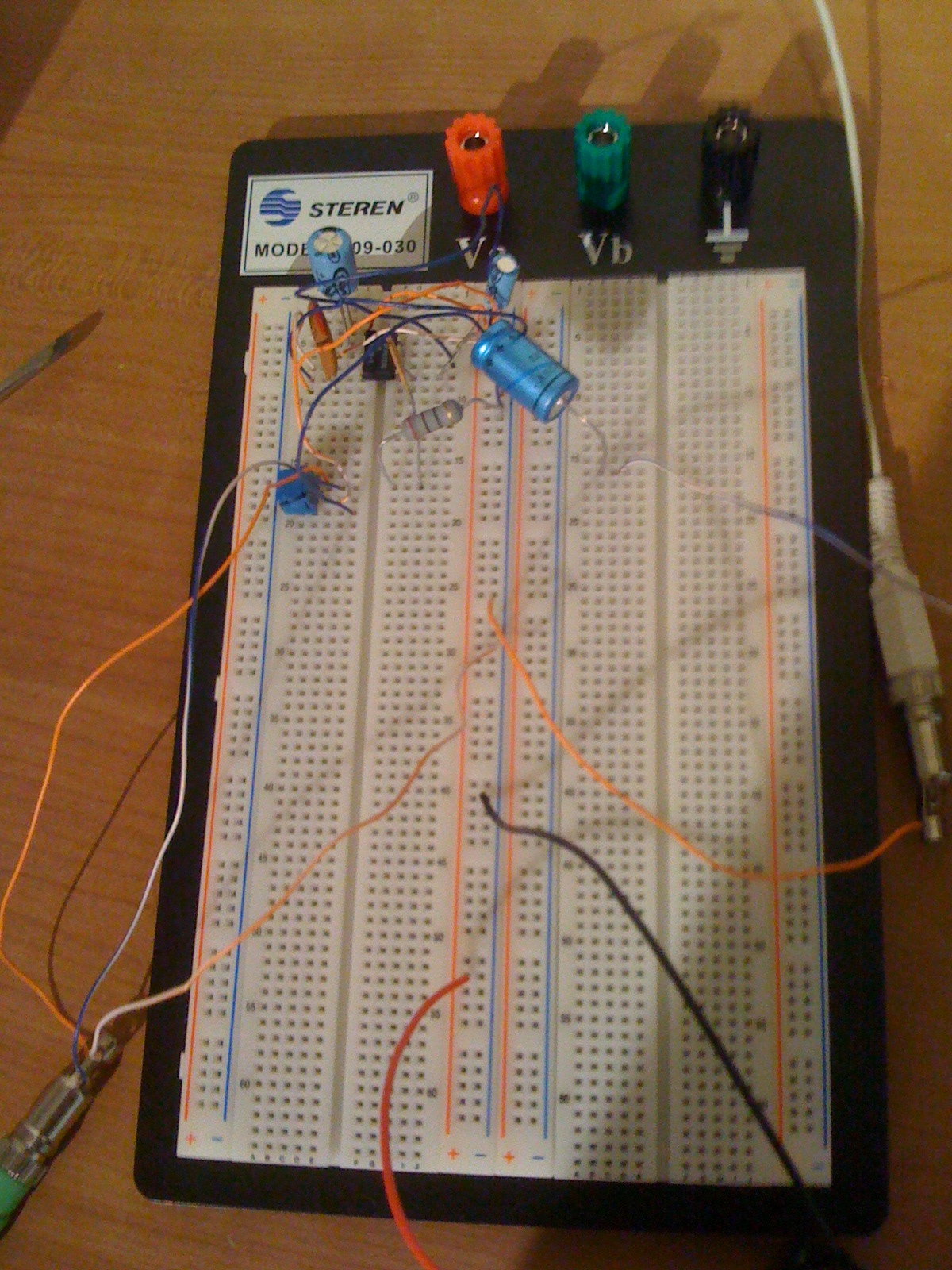

I bought a breadboard and I built the circuit that had 1 LM386 and two LM386's, and the bass boost circuit in the datasheet, no matter what I did the quality of the sound was horrible! But I can upload pictures of it if you guys want (my first circuit on a breadboard)?
I was so exited though to hear sound even though it was crappy. :)
EDIT: Any ideas to decrease distortion?
One idea is to use better amp chip:eek:
You need to say more about the input signal you're feeding it up. Are you able to adjust the volume using the put pot?, else re-wire it. Please don't test your amp while listening through headphones!

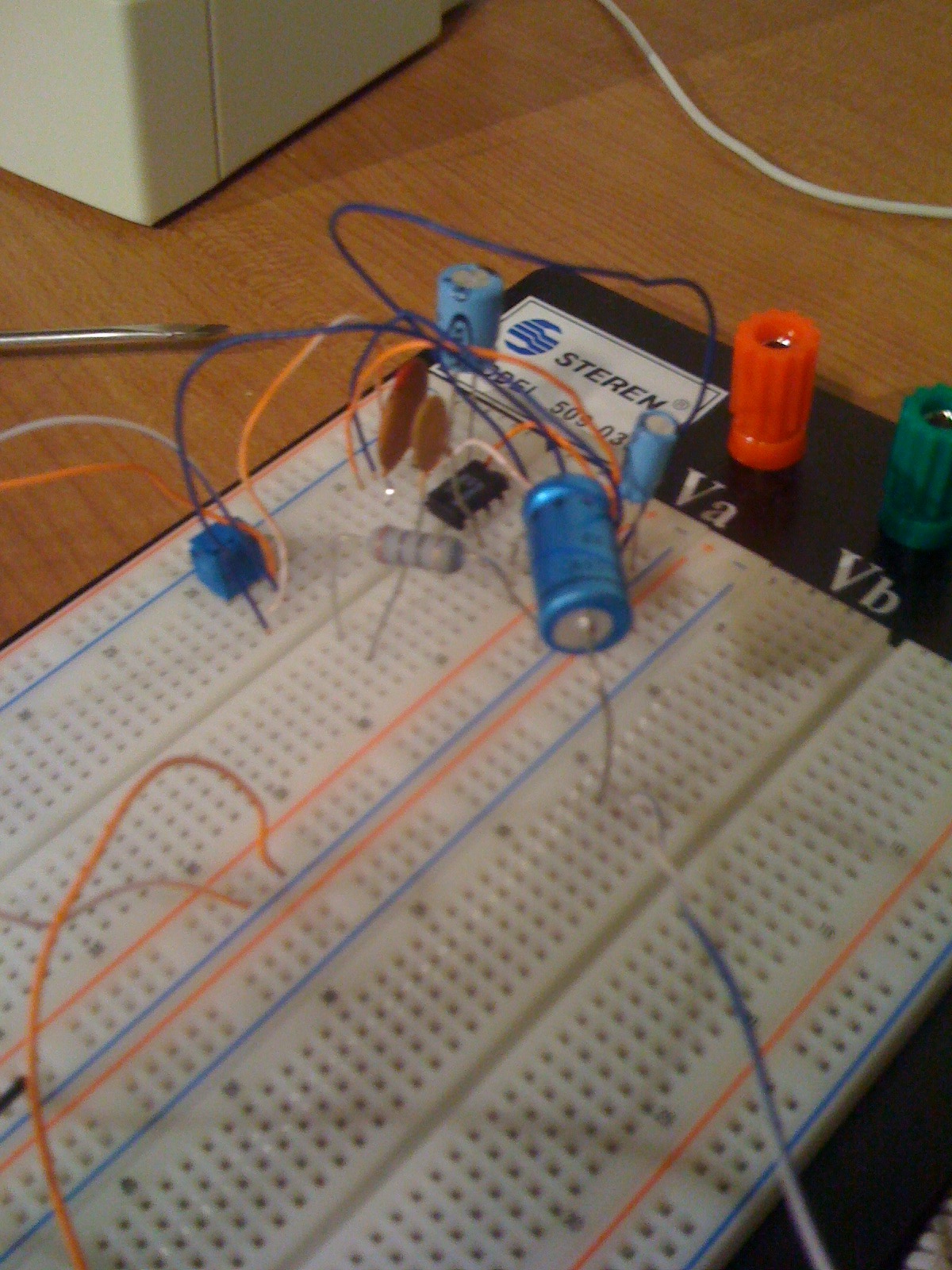

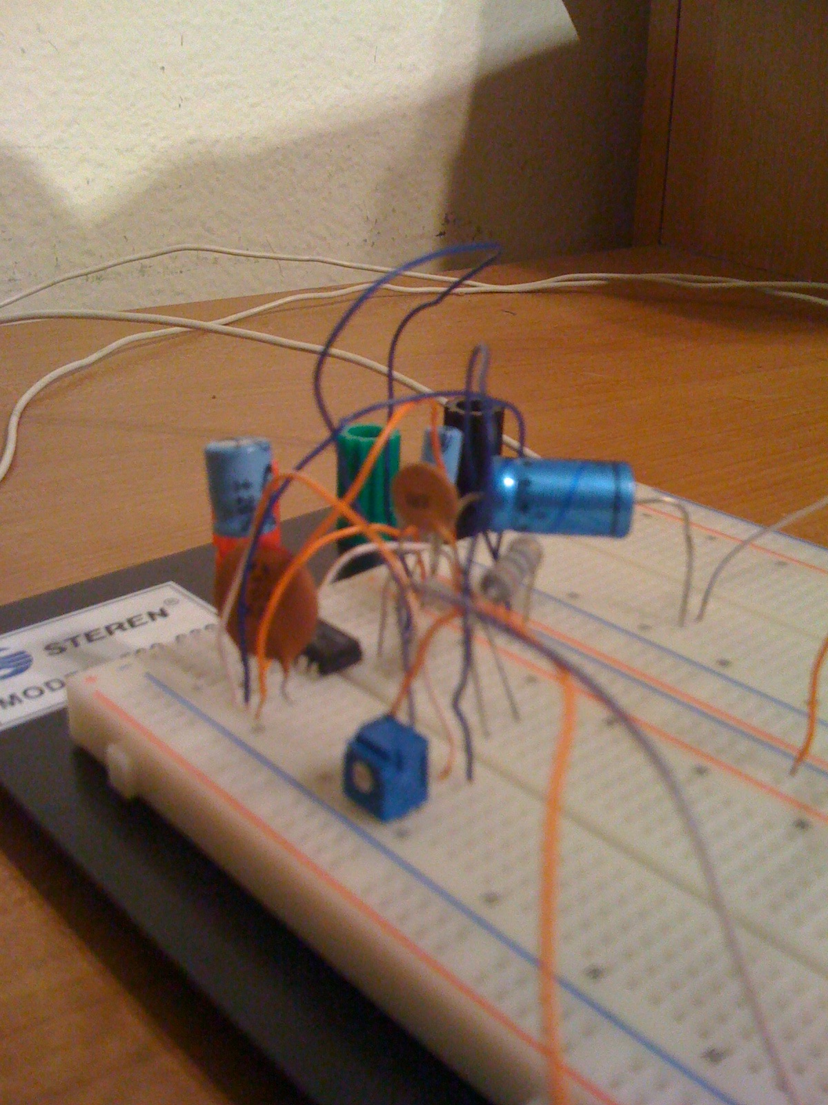

An LM386 amplifier has good response up to 500kHz so it will probably oscillate when built on a breadboard. The bass boost circuit adds extra negative feedback at high frequencies which increases the possibility of oscillation.
Make it on a compact pcb or stripboard and use a proper supply bypass capacitor that is not shown in the datasheet.
The distortion is typically only 0.2% with an 8 ohm load and is much less with 32 ohm headphones.

EDIT: So you guys know, the input is an MP3 player and the output is a stereo speaker through an auxilary jack. I'll upload pictures.
Did you notice that the new circuit hs two supply bypass capacitors and your first circuit had none?
(Hits hand on face in embarrassment): Which happened to be what you were telling me from the start...
Why does the supply bypass capacitor make such a difference?
Because the battery has a fairly high internal resistance. Then when the output draws current from the battery, the resistance of the battery causes its voltage to drop. So the battery voltage fluctuates up and down with the signal and feeds back into the input causing oscillation.
