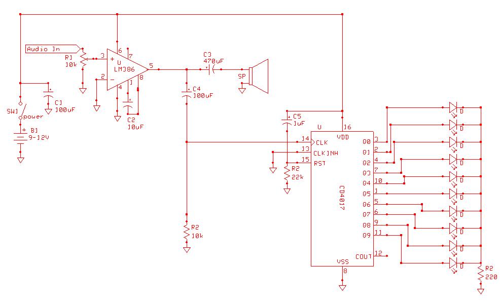

i understand what you're saying now new guy. thank you for clarifying in chat. what you want is a circuit that can flash the LED at higher volumes rather than having it dim. if that's the case then you can try a setup like the one i showed you yesterday, or you can wait a little while and i will give you 2 complete circuits that should both work. the problem, is that like audioguru said, you're going to get a serious reduction in sound quality. you can fix this by using another 386 that is coupled with your first one.
and for the record, i agree, the 2822 is a good amplifier.
i have made these circuits, hope they help.
They are missing the very important Zobel network (0.05uF capacitor in series with 10 ohms to ground) at the output which prevents the amplifier from oscillating. Every circuit on the datasheet has it.
duely noted, i made the scematics based on the circuit i had built, that little capacitor and resistor somehow managed to stay hidden.
I don't know why people bother incorrectly copying schematics from datasheets when they can easily copy and paste which is guaranteed to be right.
