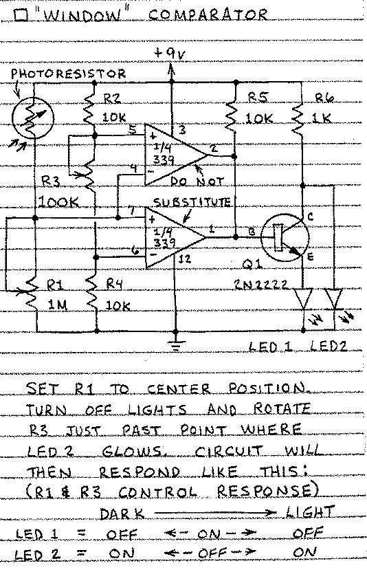

Attached is a classic example, when Q1 turns on LED is supposed to light and LED2 is supposed to go off. This won't happen, LED2 will remain lit and LED will light very dimly due to the tiny base current.
Forrest, loves the 741 but you should replace it with a TL071 or TL072 which is a much better audio amplifier.
