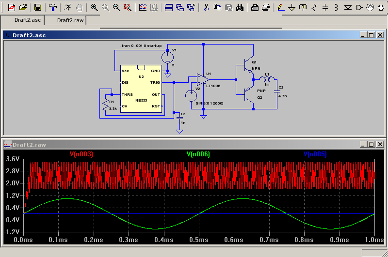

I took a stab at trying to amplify the signal class-d style. The red waveform is the sawtooth input, the green waveform is the audio input (which here is a sinewave signal at V2) and the blue is the output. I don't know why I get this.
Now if I instead connect the inverting comparator input to the out pin of NE555 then the output is amplified, however running at the same frequency as the signal frequency from the NE555, but the output from NE555 is a square wave.
Is there any way I can amplify the original signal and still keep its frequency?
audioguru has already told you what you need for more power, a higher supply rail - different classes of amplifier don't provide any more more, they are still limited by the exact same laws.
In your class-D amplifier, the opamp (+) input is biased at 0V so its output is also 0V (the output is actually trying to go negative). Bias it at the same voltage as the average voltage of the (-) input.
Ok, so it seems a bias here is helpful as I receive a better (yet not perfect) waveform. I'm not sure if I have to apply a bias to both inputs or just the sawtooth input when hooking it up to the ISD AUD/AUX output.

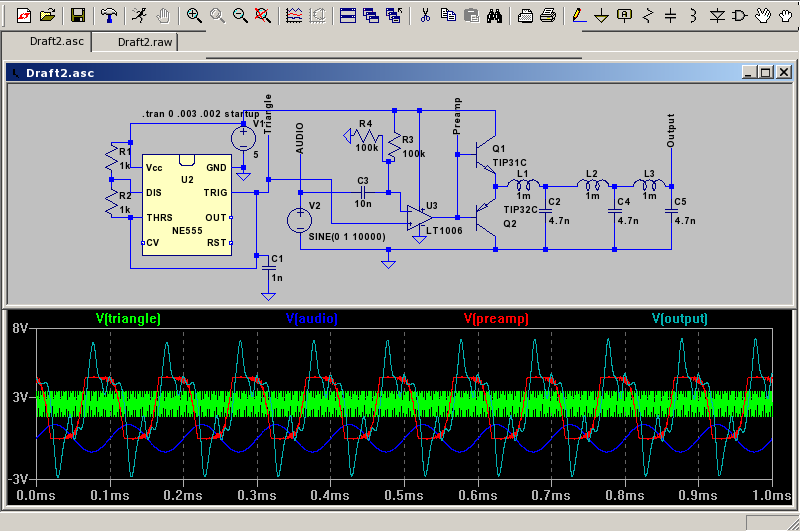

I noticed as I was measuring the output at each inductor that there were more waves than usual (Do they call this ringing?)
The red preamp seems to produce the output at the right frequency and better amplification but somehow I need to make that waveform rounder. I wonder if my transistors are incorrect or if the inductor values are incorrect or am I missing something?
Since you are using a slow old opamp instead of a fast modern comparator then the red signal is a rounded awful looking "rectangular wave".
Your LC lowpass filter is resonating at its tuned frequency instead of being a filter. Look at the amplitude of the output from the filter, it is much higher than the power supply voltage and it even swings to a negative voltage when there is no negative supply voltage for the circuit.
Which comparator that LTspice has would you recommend I use to test with?
So I must be completely on the wrong track? Is there a better way to implement the filters?
Your supply voltage is still only 5V so the output power of your class-D amplifier will be very low.
I do not know if LTspice has a comparator. I have used LM393 dual comparators and LM339 quad comparators. I have used excellent switched capacitor lowpass filter ICs.
A Butterworth lowpass filter alignment has a flat frequency response before its cuts high frequencies. Use an active filter that has opamps, resistors and capacitors.
