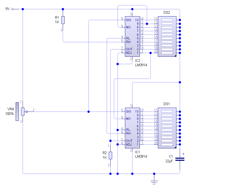

Sorry to be a burden once again, I've been breadboarding layouts all night with little success. I can get a 10 segment version to work fine, but the 20 segment version doesn't work past 9 segments.
Once the 1th segment lights, it sticks and no further LEDs light up, this is when I feed it 4.5v.
I have (hopefully) attatched a schematic showing the circuit I'm using, does this look ok?

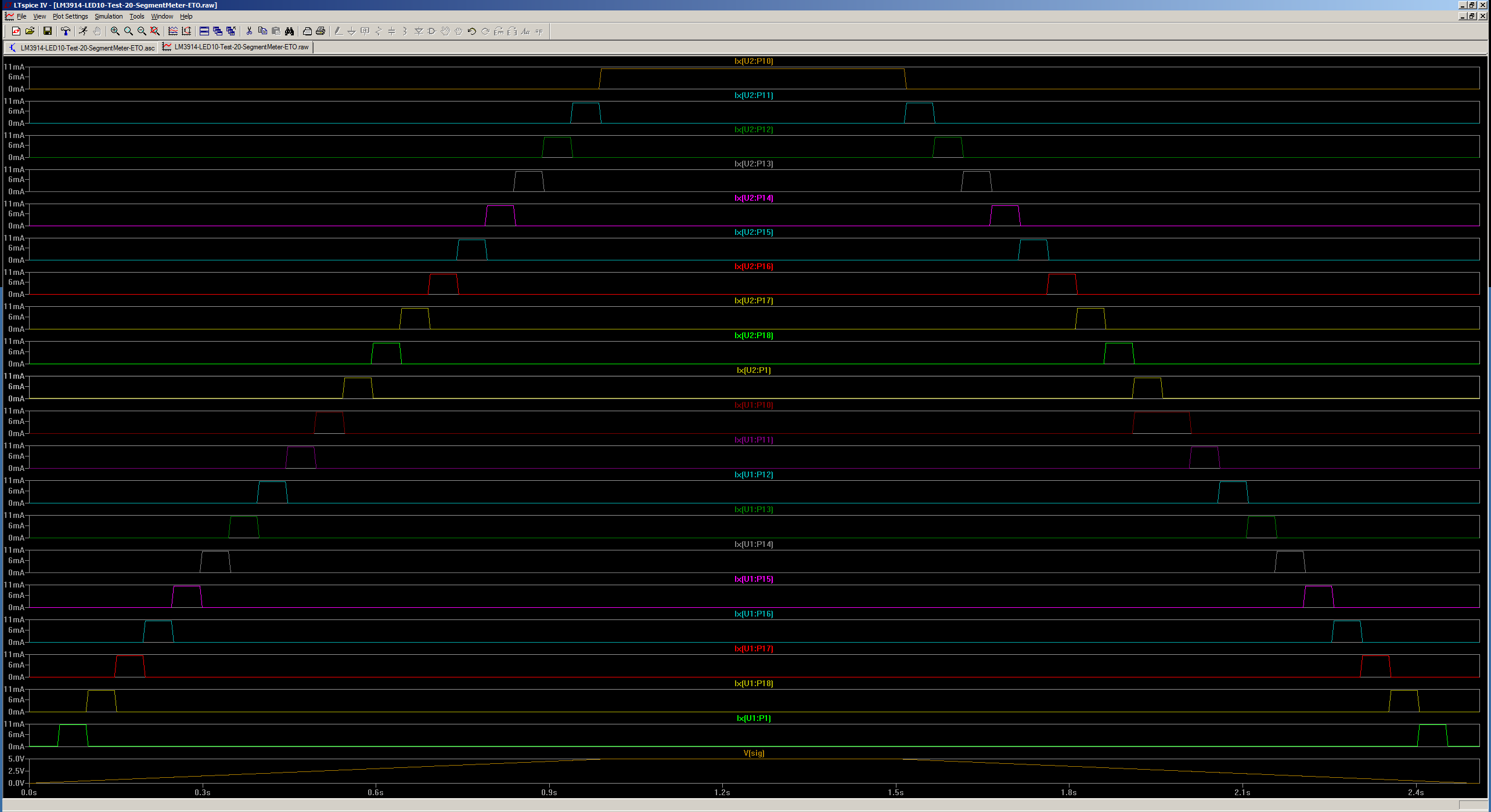

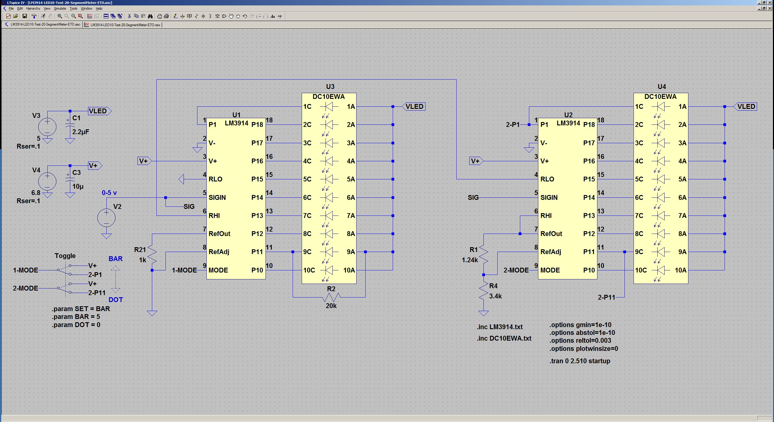

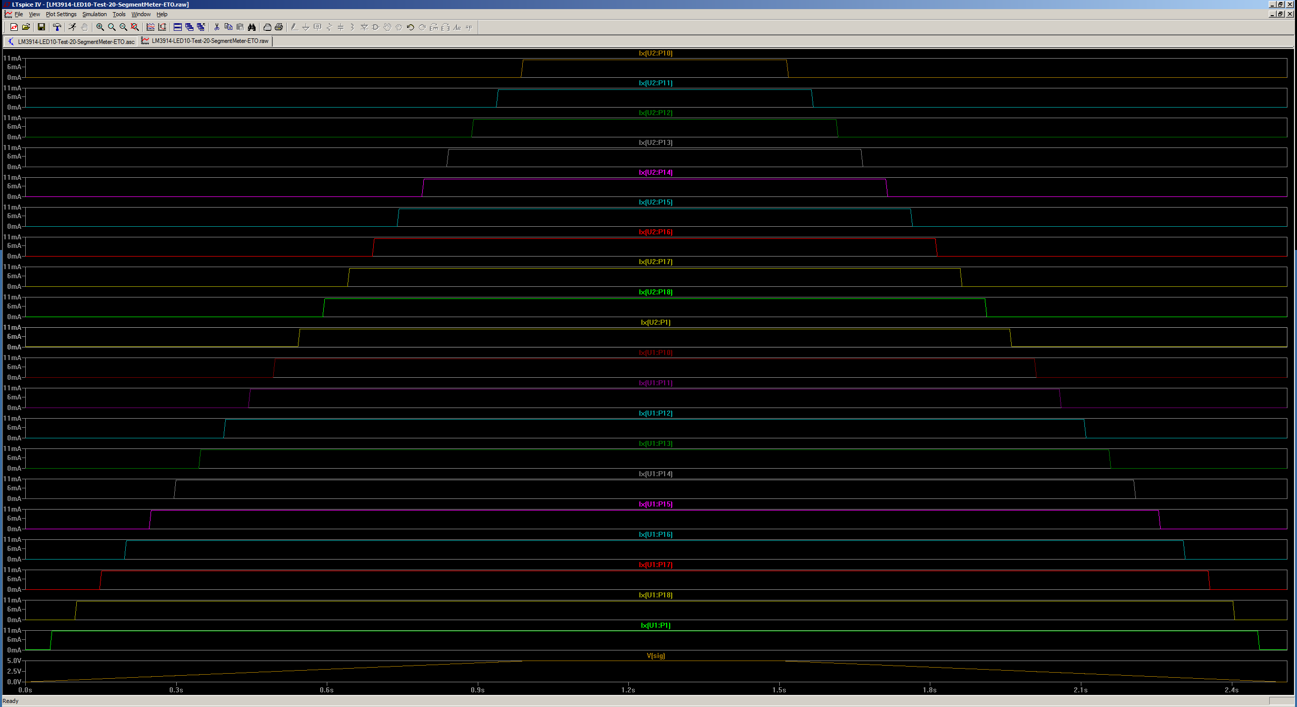

Right, it works fine for bar mode, however when connecting pin 9 of lm3914 1 to pin 1 of lm3913 2, and pin 9 of lm3914 2 to either pin 11 or completely disconnected as is mentioned in the datasheet, I get led 10 lit as soon as the lower scale in exceeded and it stays on. Any ideas as to why this is happening?
Here you go...
one shows circuit
one shows DOT graph
one shows BAR graph
eT
