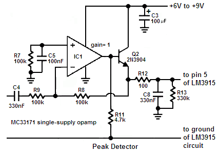

Why don't you use a simple single-supply opamp as the peak detector like I did? It can have any amount of gain to avoid clipping.

My peak detector is a simple one that uses just a diode on the anode of a 22uF capacitor, and a 10k resistor to ground. All of which fed into the pin 5 of the 3915. The problem that I'm having with the buffer amp is that when the volume is lower, the signal needs to be increased (it functions normally with the inputs connected to the respective leads of the speaker). However when the volume gets turned up on the radio, a resistor needs to be added to between the inverting and non-inverting inputs on the buffer amp.

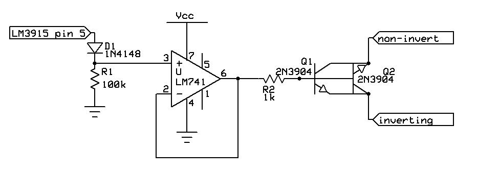

In the 2 schematics that I've posted are of the circuits that I'm using. The first is of the peak detector and the buffer amp, the second one is of the circuit that I was going to try to use to control the gain of the buffer amp (may need to add more diodes to the positive feedback to allow the voltage to drop more rapidly). The LM741 is going to be replaced with an ICL7611.

You never short together the inputs of an opamp to reduce the gain. You simply add more negative feedback by bypassing the feedback resistor. A single transistor or Jfet can do it if you use a single-supply opamp.
A lousy old 741 opamp is not a single supply opamp and will not work in your circuit.

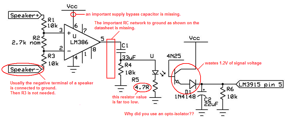

Your odd circuit creates many questions:
To start, the bypass capacitor for the supply is 220uF and is used by all of the ICs in the circuit not just the 386. According to the PCB, the speaker is connected to ground, but for some reason my ohm meter reads that there is a 10 ohm drop some where in the circuit (without power and without the speaker attached. The missing RC network was a mistake that I made when I originally built the circuit, but once I added it, it didn't seem to make any difference in performance so I just left it out to save some parts. The 4.7 ohm resistor needs to be such a low value because if I go any higher, the transistor on the other side of the isolator will not respond to the signal. The opto-isolator is included because of a trade off that I made in the design; if I use a single 3915, then the signal will cause it exceed the reference and all of the LEDs stay on most of the time. However, if I used 2 LM3915 ICs, then the signal would only light half of the second IC which is not what I wanted.
The 741 was just a cheap IC that I decided to use for the experimenting portion of this circuit. Like I said yesterday, It is going to be replaced with an ICL7611, 1.4MHz op-amp. I don't have access to any single supply op-amps, but when I get my charge pumps in a few days, I can make a dual supply.
The datasheet for the LM386 power amp shows the important RC network in evey single schematic because the IC oscillates at a high frequency without it.
Your opto-isolator needs a very high input current for a small output voltage. You set the reference voltage of the LM3915 too low at only 1.25V. Your opto circuit simply attenuates the input signal because it has many voltage losses. If you set the reference voltage higher then the opto is not needed.
You have the reference voltage of the LM3915 adjusted to only 1.25V instead of a higher voltage (by using two resistors).
The 741 opamp is 42 years old. Many much better modern opamps perform much better and cost the same or less.
All modern countries have many distributors selling modern opamps. Do you live on Mars??
1.) You say that I shouldn't connect the inverting input directly to the output of the op-amp, why not?
Because it makes the voltage gain only 1 like a piece of wire.
