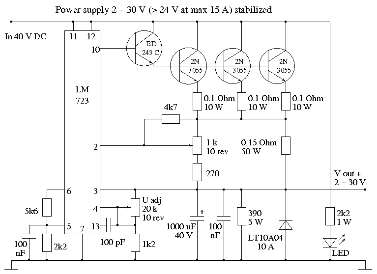

i,ve attached herewith a diagram of adjustable power supply using lm723 regulator and transistors. the voltages of the circuit are the same as i need. but the current limit is described by author of the circuit as from 4.2A-to-18A. i want to modify it for a current limit range from 100ma-to-5A only.what changes should be made? i think i understand the transistors part of the circuit but can,t figure out the resistor values and power, or other ciritical changes to be made, if any. so please give me an advice. i am posting the link to the web page also.the ciruit in question on the web page is "C. Regulator part with variable current limitation (4.2 - 18 A)" thanks to all.Stefan Spnnare: Power supply

I strongly recommend to look for a better circuit. That one appears to have been made a century ago.
If you want to use it to heat your room it will suffice.
Boncuk
Current calc
Here is an excel sheet with a diagram and some calculation that show current limits. Just change values of the resistors and find different limits. But pay attention that this circuit, as told by Bonkuk, dissipates a lot of power in current-limit conditions.

oh,sorry........ one more thing important i forgot to mention in my first post is transformer. the transformer that i want to use is center taped 18v-0v-18v @ 5A max. so the circuit will have to regulate the current from 100mA-to-5A, and voltage will be regulated from 2v-to-max available rectified voltage.
during regulation of voltage or current heat is always generated. even simple regulator LM317 get hot a lot at max load. and without a large heatsink cannot be used.
if the circuit in discussion is very old, then please please give me a link to some good design that could be made at home.i must have current regulation. i have seen a lot of designs with LM723 on internet.they all lare based on same basic design with different regulations of voltage and current. thanks a million.
Using a 723, current limiting takes place when the voltage between pins 2 and 3 is 0.63 volts (or there abouts).
In this circuit, that voltage is developed across the 0.15ohm resistor.
At 4.2amp the voltage across the resistor is 0.63 volts.
At 18 amp the voltage across the resistor is 2.7 volts.
The current limit control, when set to one end of its travel, connects the resistor directly to pins 2 and 3. The current limit is 4.2 amp.
When the control is set to the other end of its travel, the voltage from the 0.15ohm resistor is divided from 2.7v to 0.66 volts. The current limit is 18 amp.
To have a current limit of 100mA, you will need to change the 0.15 ohm resistor to 6.2ohm.
However when 5 amp is flowing through this resistor, the voltage across it will be 31 volts, and the power dissipated will be 155watts, a bit excessive!:eek:
Using this circuit configuration, you current limits are not practical without switching the current sense resistor.
The output voltage cannot be adjusted to the maximum rectified voltage.
There must be some voltage across the 2N3055 pass transistor, so the maximum output will be a few volts less.
Use a 10R variable resistor in series with the 0R15 for the sense resistor, just make sure it can handle the current.
You're using a centre tapped transformer so it's fairly easy to add tap switching circuit similar to the one posted above.
