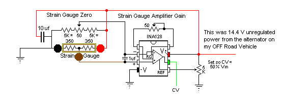

load Cell amp
Here's what I use for amplifying the output from a strain gauge, I needed about 1 volt and had to amplify my signal by about 3000. Don't seem to have much problem with it. It's a Texas Instrument INA128.

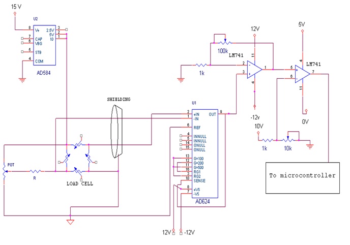

Comparator Design Needed
I am using 2 stage amplified load cell signal. First amplification from AD624 and then from non-inverting op amp. Now i need to compare it with a threshold.
But the problem is that when i give amplified output into the comparator, the change in weight on load cell does not affect the output of amplifier rather it remains constant.
Why it happens ?
Can you post the schematic (drawing)? Really hard to see the problem without a schematic.
Ron
here is the circuit diagram attached in attacment
The schematic is available in the attachment
