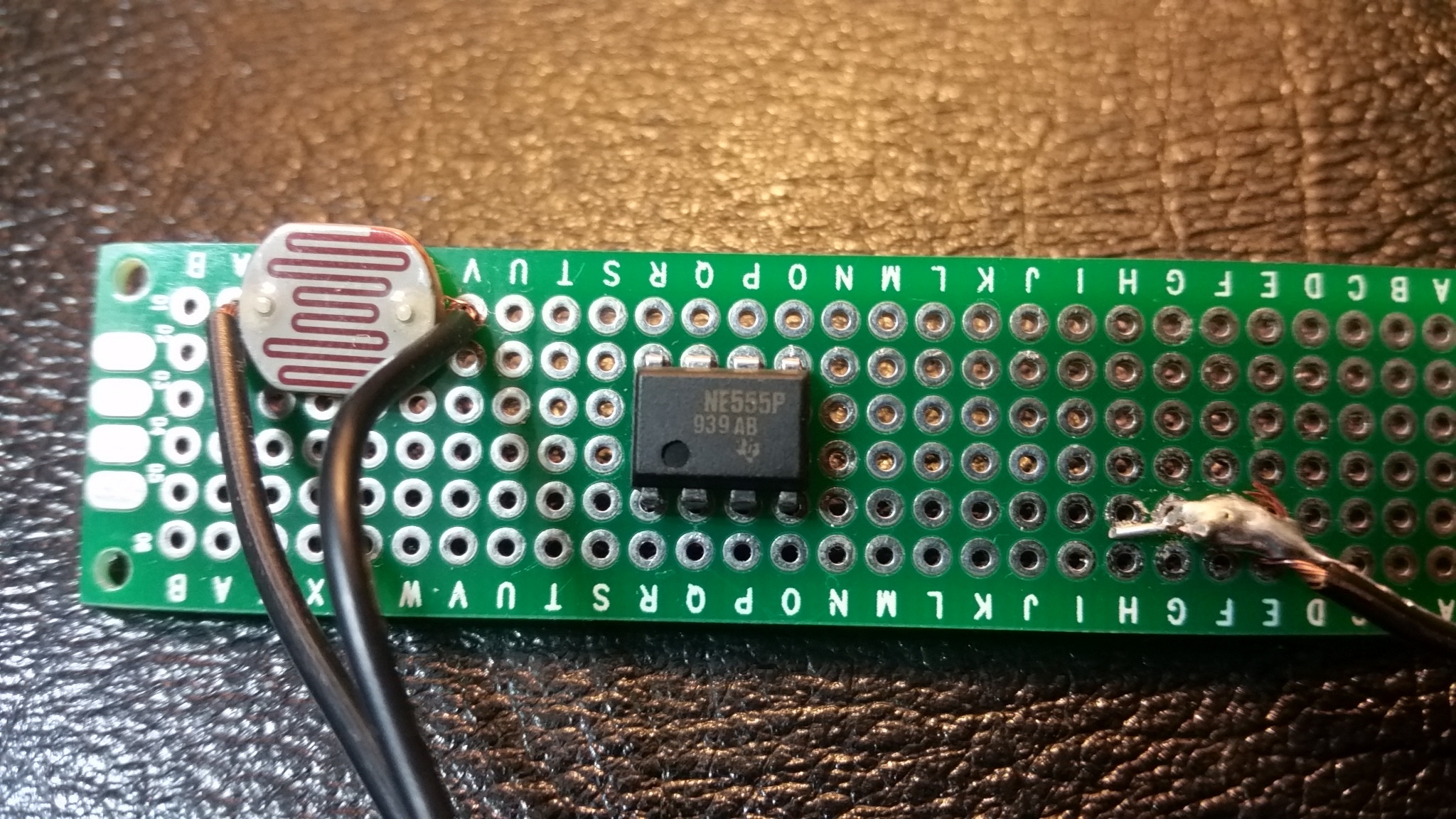

Location of pin #1 of NE555P chip
The end pin by the circle is pin 1. The pins number 1 to 8 anticlockwise from pin one. If yours has a half circle on a short end, pin 1 is on the side to the left of the half circle. All these are viewed from above.
Thanks. I have a single pole double throw switch.

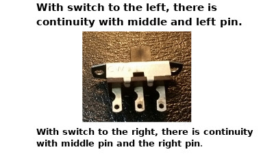

How do I hook up my switch as shown in this diagram?
I am thinking that pins 2 and 3 are involved.
To turn off the alarm and reset the system, a (single pole double throw) switch disconnects the speaker and sends the LOW signal from the output pin 3 to the trigger pin 2. The system is now deactivated. To reactivate it, flip the switch back to the original position. The alarm will remain off until the next time that the light beam is interrupted.

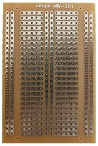

I can see that my board will be difficult to use.
I have to solder several things to some of the pins.
What is a better board?

You can use this board. Just put things you want to connect to each other in adjacent holes, push the lead in deep enough (or strip wire long enough, to allow it to connect to adjacent holes on the back side of the board.

Assuming the diagram is correct, the switch common should connect to pin 3 and the normally open contact to pin 2. It looks like a slider switch so the central tag(s) is 'common' (pin 3) and connect one of the outer tags to pin 2.
Where do I hook up pins 2 and 3 on this switch?
Would one go to the middle and the other to either of the sides?

Connect the middle pin of your switch to pin 3 of your chip. Connect one end pin of your switch to speaker (-) and the last pin on your switch to pin 2 of your chip.
