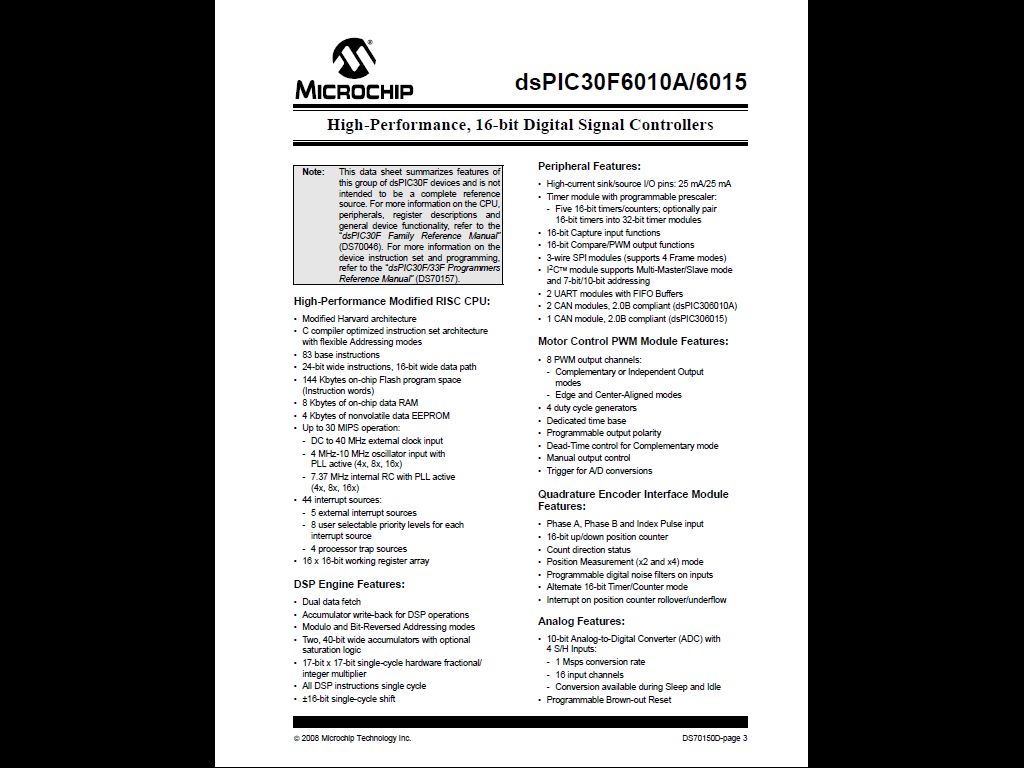

just like the pickit 2 its 10.2ms window. If anything i can use:
dsPIC30F6015
Its a beauty of a PIC even if its $10 its a great choice i believe.

For a simple logic analyzer a DSPic is overkill. The advanced functions are simply not needed. Personally I'd use an AVR, or a PIC with a PLL clock multiplier, preferably one that has external ram capability, SRAM modules are not that expensive. Then capture buffer size isn't so much of a problem.
Hardware for a simple logic analyzer is easy and plenty of hobbyists have made them.

heh it is a overkill but somewhat like you said i rather have a overkill then a underkill lol meaning i rather have tons of options on a pic and not use then have one with no options and be in need of external parts.
This had 4KB vs the 1KB on a normal pic. If i use external memory most of the memory out there has around a 5ms write time and how would i capture 10uS data if it takes 5mS to write it lol
even 1mS is too long. I rather be able to write to eeprom anyway. Everything on chip. Thats a nice idea tho. You are a smart fella. You have any good thoughts on memory (EXTERNAL) that i might have a look at? Some links?

Atom, it's simply, go with a cheaper pic that has the ability to use external memory. Then you can buy big SRAM chips. You'll get MUCH more memory for the same price as a DSPic
Thanks i completely understand what you are saying its just that most external memory takes too long to write to. By the time i write to it i would have missed a bunch of captures.
External ram should be far faster to write to than eeprom.
5mS?! You seem to be highly disillusioned about the speed of external SRAM. You're only limited to the timing of the SRAM chip in use. A few us maybe not ms.

Sceadwian i would like to see those chips that go that fast. Can someone post me a link please. I do believe you and would actually love to see some info on them.
It's called SRAM =)
Check digikey, access time is between 15ns and 150ns
