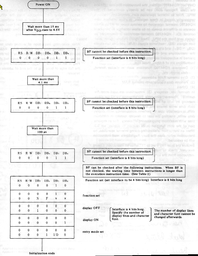

CAN you please tell me about command that is sent to instruct the LCD that it should use only four bit data? and should only upper nibble of LCD is used for that purpose?

Why don't you just read the datasheet?.
Or consult my PIC tutorial on LCD's for that matter?.
The command is 'Function set' with a specific bit cleared.

Look at this clip from the data manual.
