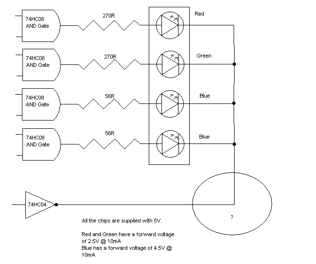

Sorry to bump again but I am not worried about the 74HC04. Will not be able to sink enough current for my application.

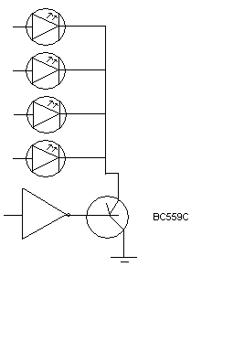

I need it to sink about 40mA (on the output pins). I'm assuming I will need to use a transistor to do the job, could anyone suggest to me how I could connect it up? I've attached a schematic to show how it's connected at the moment. The second attachment is just my idea.

The max allowed output current from a 74HCxx is 25mA and the max for a package is 50mA. Two inverters can be paralleled to drive 40mA. The LEDs need series current-limiting resistors. A single inverter can drive a PNP emitter-follower transistor and the LEDs still need series current-limiting resistors.
AG's right here, but parallel more than just two together. Our standard practice was to always use four; it's a bit more wiring but easier on the gates that way. Max current still 50mA...
A single 74HCxx inverter or gate will try to make an output current of 60mA. Two in parallel will drive 40mA into LEDs perfectly.
Unfortuantly, because of size and cost requirements I cannot use more than one inverter per set of LEDs. Can anyone suggest to me a good transistor that would switch at around 1MHz? And recommend a good way to wire it?

One 74HC04 costs only $.47US at Digikey today. It has has six inverters inside. The inverter can switch quickly because its output is push-pull. A single transistor turns off slowly but a complimentary push pull pair can switch quickly.
