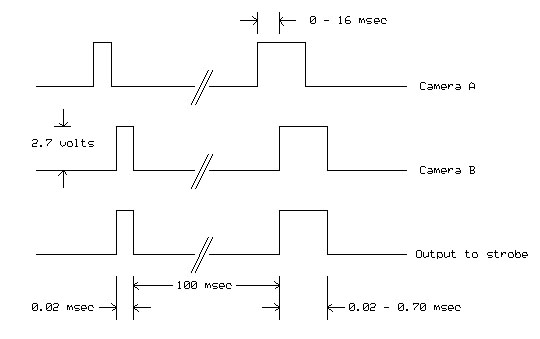

I am trying to design a simple logic circuit to combine the flash pulse from two cameras to trigger one of the camera's flash units for stereo photography. I've been using a PIC up to this point, but the logic seems so simple, using a PIC seems over kill (and too expensive).
Each camera produces a short pre-flash test pulse, reads the test image, calculates the main flash pulse needed, then takes an exposure with the main full flash pulse. The intensity of the flash pop depends on the length of the flash pulse. The camera produces the main flash pulse at the beginning of the exposure, so I use the second main flash pulse of the two cameras so that when the camera shutters are out of sync, the flash pop appears on both exposures.
Anyway, I've been trying to come up with a simple latch or flip-flop circuit to do the job, but I can't get it.
Here are the flash pulse wave forms. The first two are sample traces from each camera, and the third trace is the one I would like to send to the flash strobe unit, which is simply the later of the two camera traces. The circuit will need to run on 3 volts. Any help would be much appreciated.

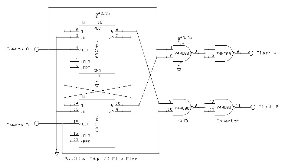

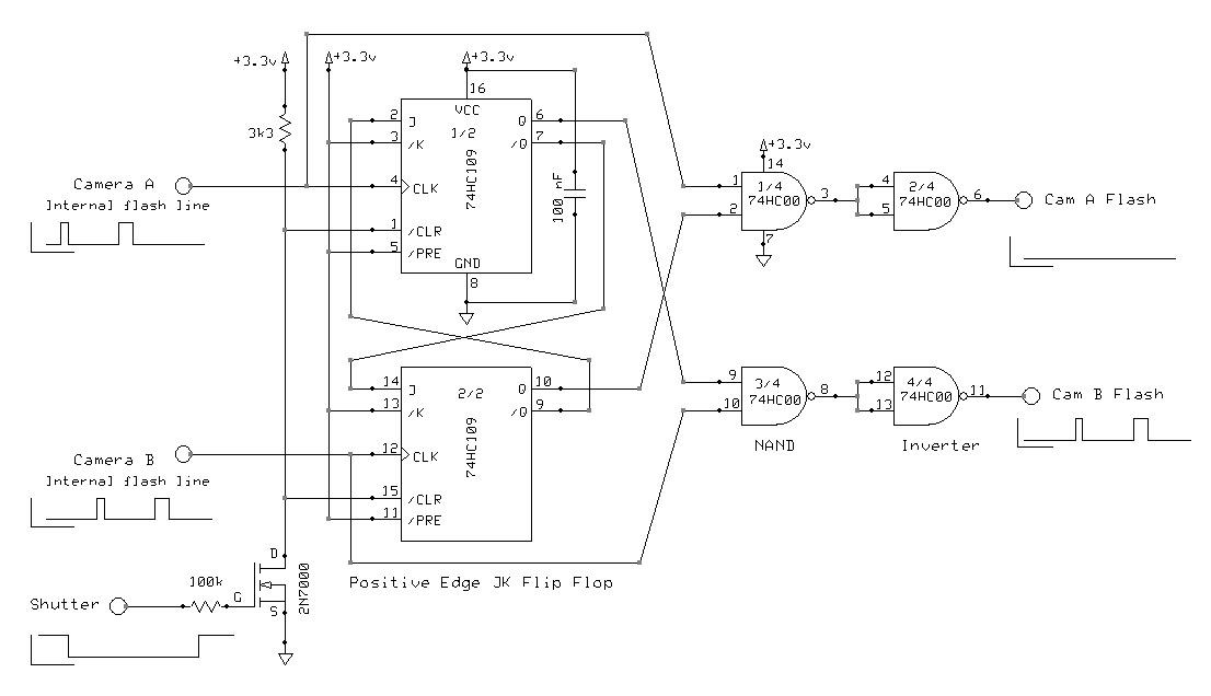

I included a schematic based on your description with some part numbers that seem to match. I used a positive edge triggered JK flip flop with the capability of a low voltage supply. I also included a single OR logic gate to combine the pulses, also low voltage.
Does this circuit need extra parts to do a reset after the last pulse in preparation for the next pair of pulses?

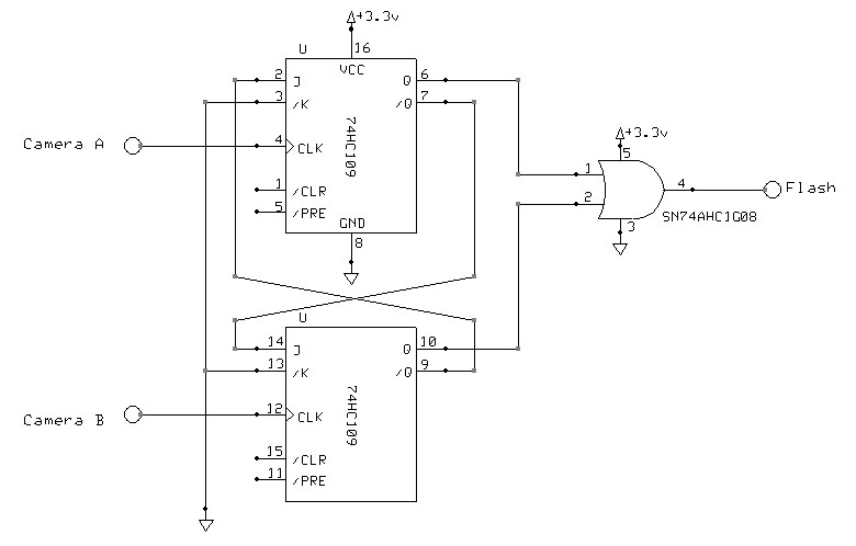

Opps, I missed your edit. Here is an updated schematic to reflect your changes.
I can add an OR gate at the right side to combine the two flash pulses. Actually, leaving them separated suits me better because I need to pipe the result back to the internal flash of each camera, and it would be better to have only one camera flash go off rather than both.
There is one error. The K input is active Low, so it needs to be connected to the +3.3 Volt line (see my comment about K in my first post). CLR and PRE are also active low. So connect PRE to the +3.3 Volt line also.
Tie the 2 CLRs together and connect to the junction of a 3k3 resistor (other end to +3.3 V) and a push button (the Reset button). The other side of the PB goes to Gnd.
You need a 100 nF ceramic capacitor between pins 8 & 16 of the 74HC109 to act as a bypass. It will NOT work properly without this cap.
You can use one of the NAND gates to do the OR function - unless you need them as inverters as drawn.
I can add an OR gate at the right side to combine the two flash pulses. Actually, leaving them separated suits me better because I need to pipe the result back to the internal flash of each camera, and it would be better to have only one camera flash go off rather than both. I don't understand this point.
I don't see how you can keep them separate.
I thought the whole point was to output one waveform which is the later of the 2 input waveforms.
To do this, you have to OR the outputs of the NAND gates.

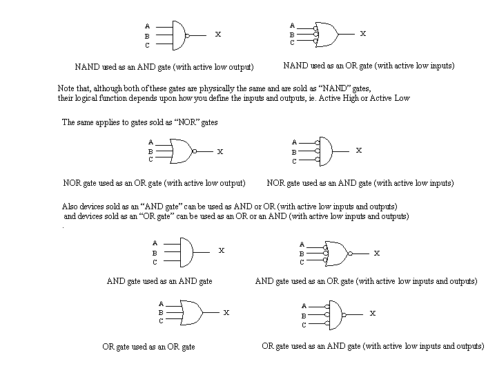

As I said, you can use one of the NAND gates as an OR gate (see attachment). The 4th NAND gate will then be spare and its inputs should be tied to Gnd.

Here is the updated schematic. Rather than use a reset button, I linked the reset to the shutter button circuit. The shutter circuit just has a pull up resistor, and is grounded when the shutter button is pressed. I needed the MOSFET to reverse the logic of the shutter circuit.
Logic tables for these flip-flops are hard to follow, but this circuit is looking pretty good to me!

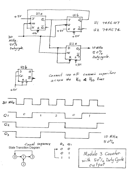

Hermit,
Here is a circuit I designed for someone in this forum a year or 2 ago.
You may find it helpful in advancing your understanding of sequential logic.
Note that U1 is a -ve edge trigger JK and U2 is a +ve edge trigger D type.
Ignore U2 at first, only study how U1 is configured to act as a Modulo 3 counter. Then look at U2 and how it provides a 50/50 duty cycle.

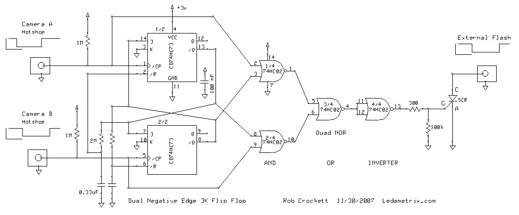

Len, your comment previously about using a NAND gate as an OR logic is making sense to me now. Here I am using NOR gates as AND logic.

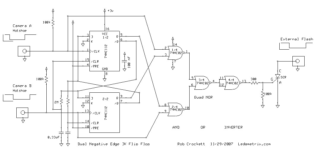

Here is a go at converting the previous flash circuit into a active-low version for cameras with external hotshoes and a external hotshoe flash. I took your advice to step through the logic, in this case starting with the output and working back to the input.
I think the 2M resistors and 0.33uF caps will work to reset the latch function of the flip flops after about 660 msec without a reset button. The hotshoe of the cameras will typically pull the center pin low for at most 120msec, so the reset time out interval should be plenty. The input impedence for the flip flops is quoted on the spec sheet at less than 0.1 uA, so I should be able to get away with the 2M resistors.
By swapping the SCR for a MOSFET for use with modern low voltage flash units, this circuit would use about 15uA, maybe low enough to power it from the flash trigger voltage without a separate battery for the circuit.
Very good. You seem to have grasped the ideas.
I notice that both of the AND gates are enabled initially and when a FF is set, it disables the other gate. Whereas in my circuit, both gates were initially disabled. Your method means that the first pulse is sent to the output whereas in my circuit, it was the second pulse.
I assume you prefer it this way.
Another way to do it would be to have both gates disabled initially and when the pulse arrives, enable the relevant gate to pass it through to the output, ie. connect pin 3 of the NOR to pin 6 of the FF (/Q) and pin 8 of the NOR to Q/ of the other FF (pin 7).
Yes, I see you are right! My intention was again to have both gates disabled initially, then a FF would enable the opposite gate to allow the second camera flash pulse to pass. I think the design changes I made will do this. I also switched to the '73 version of the FF since I did not need the Preset pins.
Do you think the FF clock input pins need static protection (resistor and zener)? I can't seem to find information about internal ESD protection for this part.
