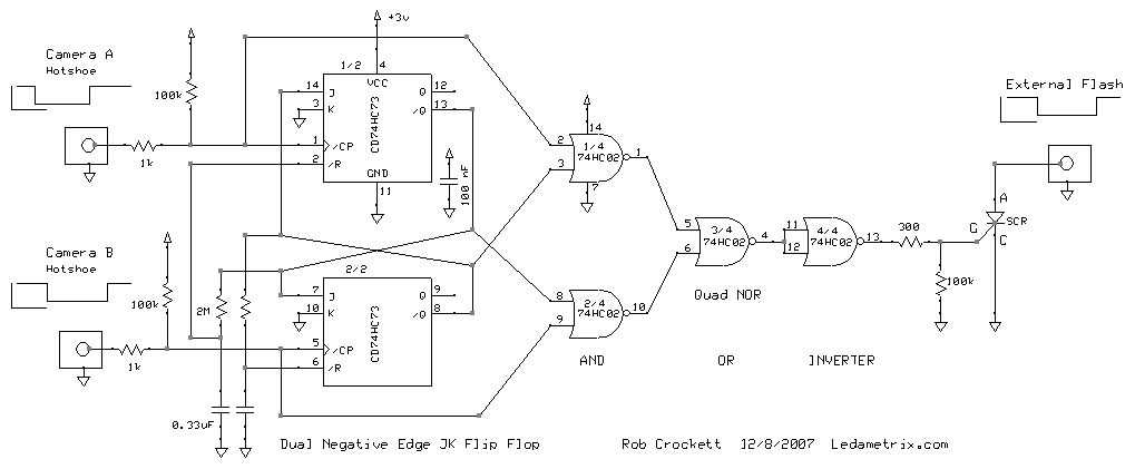

Logic circuit for two cameras and one flash.
Ok, I found some ESD information for this part in this document: https://www.electro-tech-online.com/custompdfs/2007/12/szza036b.pdf With an additional series 1k resistor on the input lines, the internal clamp diodes should be good enough protection.

Yes, I see you are right! My intention was again to have both gates disabled initially, then a FF would enable the opposite gate to allow the second camera flash pulse to pass. I think the design changes I made will do this. I also switched to the '73 version of the FF since I did not need the Preset pins.
Do you think the FF clock input pins need static protection (resistor and zener)? I can't seem to find information about internal ESD protection for this part.

Have you looked at the data sheet for the 74HC73?
What are the limits (if any) on the clock rise and fall times?
I notice that you have 1M pull up resistor on the Clk inputs.
This will result in a slow rise time if the camera outputs are open collector types.
Ok, thanks. It probably is best to allow for a little capacitance in the input lines. I decreased the input line pull up resistors to 100k, and added series 1k resistors for ESD protection. The cameras use SCR's to trip the flashs, so they would be open collector type. Here is (I hope) the final version.
I just looked at the data sheet for the 74HC73. It is a good choice for your circuit since it has Schmitt Triggers on the clock inputs. Thus it is not sensitive to the clk rise and fall times.
But 100k is a better choice anyway.
