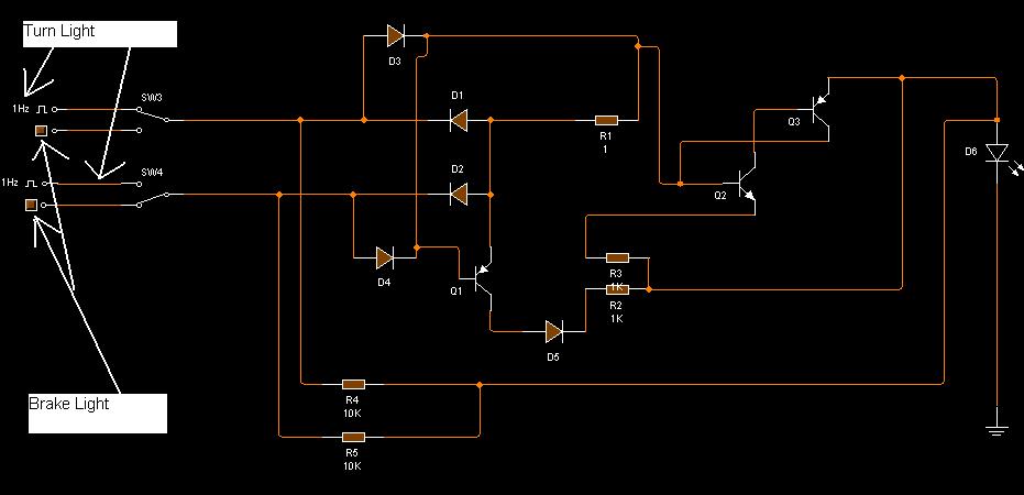

Does anyone know what the circuit look's like for the 3 Brake Light Module?. It Prevents brake light from flashing with turn signal, is on. When the brake is
on the 3 brake light is on. When the turn light is on, or toggling, the 3 brake light is not toggling or flashing.
So you hook into the (right turn/brake light) wire. Go into the Module and to the 3 brake light. With out the Module, the 3 Brake light would be flashing or toggling when the Right turn light is on.

Sounds like it uses a AND gate to detect when both brake lights are on.
AND gate wouldn't work properly either. If you are turning left and braking, then the left light flashes but right light is steady for brake, so your third would flash too with an AND gate.
I'm not sure of an easy way to do this at the rear of the vehicle with only access to the two wires for L/R bulbs without using some kind of circuit to detect when one of the two inputs is solid (braking).
Simplest would be to tap into the brake switch and use that output to directly power third brake light. In vehicles with single bulbs for turn/brake, the turn signal switch also has a brake input and when turning allows the brake input to travel to the opposite bulb to turn it on. Essentialy, the turn signal switch has the "logic" as to which bulbs get turned on.
I realize that the diodes I suggested won't work either, since obviously a single turn-signal will then cause the 3rd light to blink.
You could use a flip-flop circuit that would operate the 3rd light when both stop lights are on, and then doesn't turn it off until both lights are off. For example, an AND gate to SET the flip-flop and a NOR gate to RESET the flip-flop. (Or since some FF SET and RESET are active low, use a NAND gate for the SET, and an OR gate for the RESET). That way the 3rd light will still stay steady on when the brake light is maintaining one light on and the other light blinking, but stays off when the brakes are off and either light is blinking.
Something like this, but I can't get the circuit to work. I have put it on the Attachments.
I can't follow the logic, but what little I can understand it appears that it requires the brake and blinker to be able to sink as well as source current. In a real automobile circuit this won't happen.
^ In this example maybe not, but I can think of many other examples in automobiles where a circuit will sink OR source current in different circumstances. :)
The bulb connected to ground will sink current. Incandescent bulbs are a low impedance when cold. It could be a problem, however, if the bulbs are LEDs.

That circuit lights the 3rd light only when both inputs are on.
If the inputs were brake-light-only, there would be no need of the circuit: it could be replaced by two diodes
