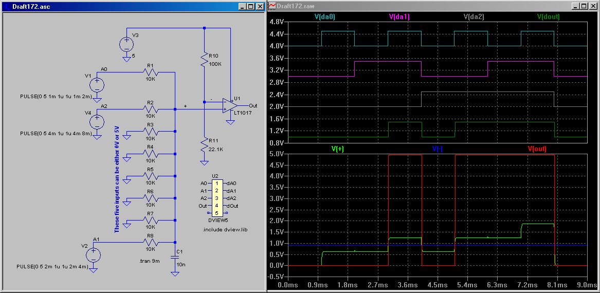

How about using an analog approach?
The upper plot panel is like a 4 channel DSO.
The lower plot panel shows the actual voltages at the named nodes.
The comparator is not critical.
If you can use an analog approach then just sum all the inputs through equal value resistors (one resistor for each input) into a comparator. Select the comparator threshold to about 3/16 of the logic high voltage such that more than one high input triggers the comparator.

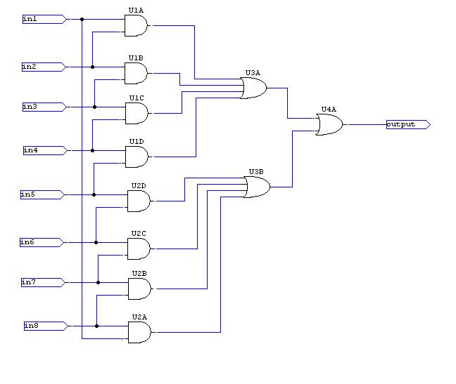

see the attached, two out of eight selection and then or..

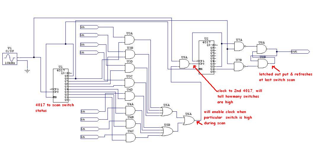

can be implemented using 4017 with sequential logic as shown.. the high frequency clock will be refreshing the key status, making the 2nd 4017 to set and reset the out put.

The brute force approach is to OR the outputs of 28 (check my count) 2-input OR gates to check all 2 input combinations of the 8 bits.
this should work

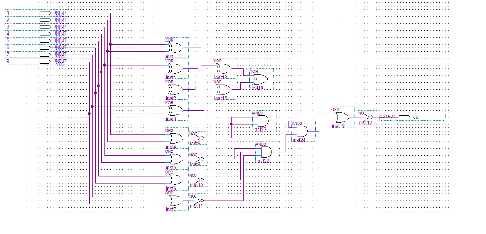

I read your question backwards, then put together a schematic. After reading it again and adding a not gate to the output I believe this circuit is all you need. Although a little robust it could be simplified by programming in assembly or using a karnoff map. I believe there a simplified way to karnoff map with a larger number of inputs.
I don't believe that will work.
With all inputs low, the output is low. Correct
With inputs 1 and 3 high, the output is high. Correct.
With inputs 1 and 2 high, the output is low. Incorrect.
There are many other sequences of more than one input high that give an incorrect logic low output.

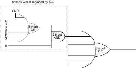

More interesting than as I originally read it... If only gates allowed (no micro);
1 answer: takes qty 9, 8 input OR gates along with qty 8, 2 input AND gates.
If this is a homework assignment, the instructor may realize you didn't think of this... Bad Dog, No Biscuit! (teehee) <<<)))
